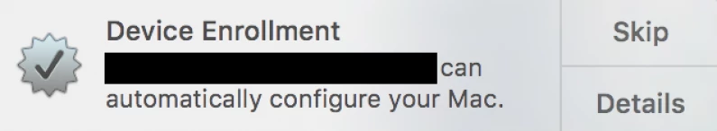

Be aware that users will eventually start getting the Device Enrollment Nag.

@ddcdennisb I believe that's only triggered if the device didn't get past the Device Enrollment page during Setup Assistant, or didn't have Internet access when Setup Assistant was initially run. When we turned on Device Enrollment and added every already deployed Mac in our environment to a PreStage Enrollment they did not get that prompt.

i did the same and a couple months in, our users were starting to get prompted.
