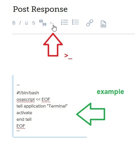

@SJBradleyNY for future reference when you want to post a script use the ">_" see screen shot for the example:
osascript << EOF
tell application "Terminal"
activate
end tell
EOF
