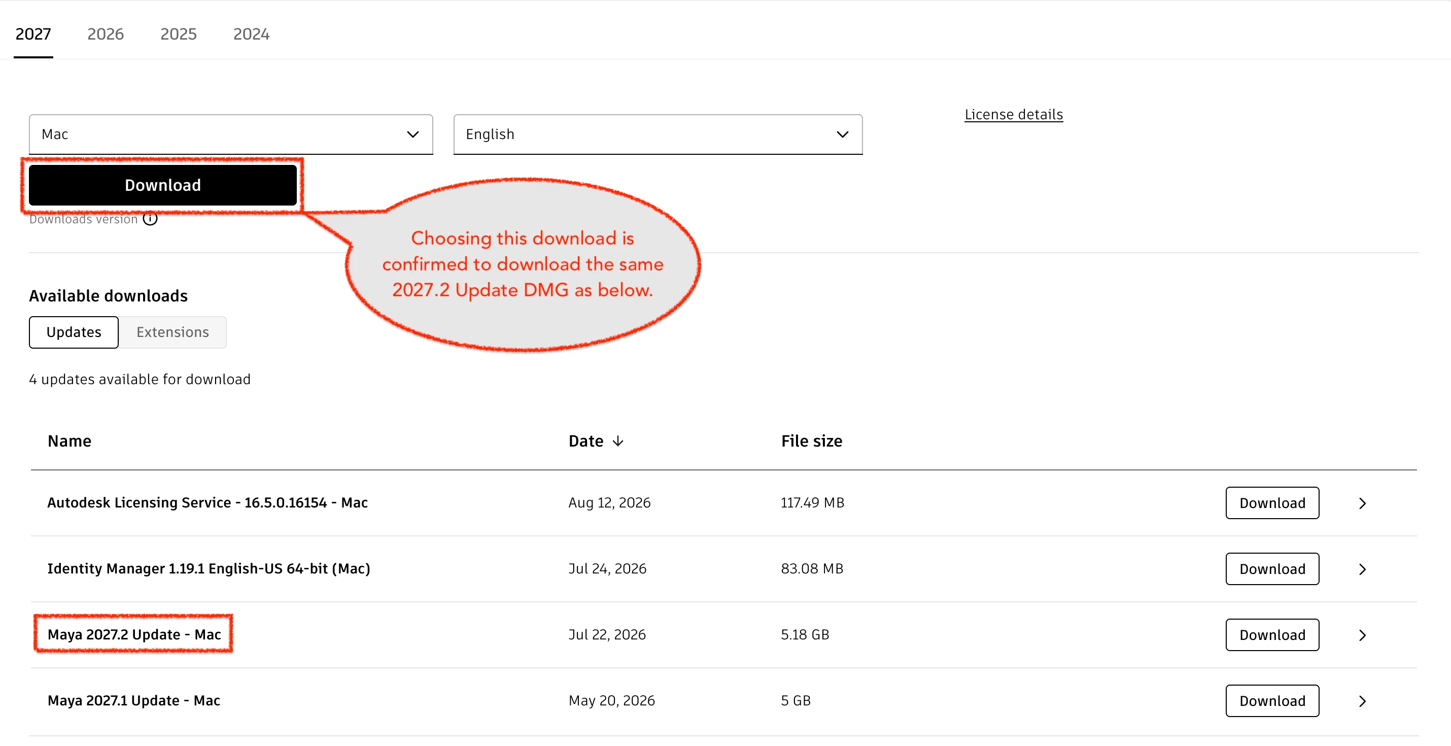

MCerano
  • Jul 14, 2026 12:04 AM UTC
Hey ​@kwoodard,
I am attempting to use your script to install Maya 2027 with named-user licensing. It stalled on the Autodesk Identity Manager, I had to manually click on “Install” in order to push it through. Other than that, everything else looks to have installed properly, even though the Jamf log says it failed. I was able to launch Maya without any issues after entering in my credentials.
Do you know how I could modify your script to get that through?
Here’s my log if that helps, thanks!
Script result: 2026-07-10 11:33:13 - === Autodesk 2027 Deployment Starting ===
2026-07-10 11:33:13 - Validating required files... 2026-07-10 11:33:13 - All required files found. 2026-07-10 11:33:13 - Step 1: Installing Autodesk Identity Manager 2026-07-10 11:33:13 - Mounting DMG: /private/tmp/Maya2027/AdskIdentityManager-UCT-Installer.dmg 2026-07-10 11:33:16 - Mounted at: /Volumes/Installer 2026-07-10 11:33:16 - Found .app: /Volumes/Installer/Install_Autodesk_Identity_Manager.app 2026-07-10 11:33:16 - Copying /Volumes/Installer/Install_Autodesk_Identity_Manager.app to /private/tmp/Maya2027/apps/Install_Autodesk_Identity_Manager.app 2026-07-10 11:33:16 - Removing quarantine attribute from /private/tmp/Maya2027/apps/Install_Autodesk_Identity_Manager.app 2026-07-10 11:33:16 - Fallback: Running installer from alternate path: /private/tmp/Maya2027/apps/Install_Autodesk_Identity_Manager.app/Contents/MacOS/setup 2026-07-13 07:39:32 - Attempting to unmount /Volumes/Installer 2026-07-13 07:39:43 - Successfully unmounted /Volumes/Installer 2026-07-13 07:39:43 - Step 2: Installing Autodesk Licensing Patch 2026-07-13 07:39:43 - Installing standalone PKG: AdskLicensing-16.0.3.14414-mac-installer.pkg 2026-07-13 07:39:47 - Step 3: Installing Maya 2027 2026-07-13 07:39:47 - Mounting DMG: /private/tmp/Maya2027/Autodesk_Maya_2027_1_Update_macOS.dmg 2026-07-13 07:39:56 - Mounted at: /Volumes/Install Maya 2027 2026-07-13 07:39:56 - Found .app: /Volumes/Install Maya 2027/Install Maya 2027.app 2026-07-13 07:39:56 - Copying /Volumes/Install Maya 2027/Install Maya 2027.app to /private/tmp/Maya2027/apps/Install Maya 2027.app 2026-07-13 07:40:16 - Removing quarantine attribute from /private/tmp/Maya2027/apps/Install Maya 2027.app 2026-07-13 07:40:16 - Running silent installer: /private/tmp/Maya2027/apps/Install Maya 2027.app/Contents/Helper/Setup.app/Contents/MacOS/Setup --silent 2026-07-13 07:42:34 - Attempting to unmount /Volumes/Install Maya 2027 2026-07-13 07:42:34 - Successfully unmounted /Volumes/Install Maya 2027 2026-07-13 07:42:34 - Step 5: Installing Darwin Runtime Environment 2026-07-13 07:42:34 - Cleaning existing Darwin Runtime... 2026-07-13 07:42:37 - Mounted at: /Volumes/Macintosh HD 1 2026-07-13 07:42:37 - Found .app: /Volumes/Macintosh HD 1/AdODIS-installer.app 2026-07-13 07:42:37 - Copying /Volumes/Macintosh HD 1/AdODIS-installer.app to /private/tmp/Maya2027/apps/AdODIS-installer.app 2026-07-13 07:42:38 - Removing quarantine attribute 2026-07-13 07:42:38 - Launching Darwin installer in foreground (full output)
Error running script: return code was 103.
kwoodard
  • Jul 14, 2026 1:04 AM UTC
Hey ​@kwoodard,

I decided to go ahead and try out your script. I thought I followed the instructions implicitly, but I got the following error logs:
2026-08-19 09:57:43 - Staging installer media into /private/tmp/AutodeskApps 2026-08-19 09:57:43 - Moving Autodesk_AutoCAD_2027.0.1_macOS.dmg from Waiting Room 2026-08-19 09:57:43 - Moving Autodesk_AutoCAD_2027.0.1_macOS.dmg.cache.xml from Waiting Room 2026-08-19 09:57:43 - Moving Autodesk_Maya_2027_2_Update_MacOS.dmg from Waiting Room 2026-08-19 09:57:43 - Moving Autodesk_Maya_2027_2_Update_MacOS.dmg.cache.xml from Waiting Room 2026-08-19 09:57:43 - Validating required files... 2026-08-19 09:57:43 - MISSING: no file in /private/tmp/AutodeskApps matching AdskIdentityManager-UCT-Installer.dmg 2026-08-19 09:57:43 - MISSING: no file in /private/tmp/AutodeskApps matching AdskLicensing-*-mac-installer.pkg 2026-08-19 09:57:43 - MISSING: no file in /private/tmp/AutodeskApps matching Autodesk_Maya_2027*macOS.dmg 2026-08-19 09:57:43 - ERROR: Required installation media is missing. Aborting.
And for clarification, the summary of my process was:
  1. I downloaded “Autodesk_Maya_2027_2_Update_MacOS.dmg” and “Autodesk_AutoCAD_2027.0.1_macOS.dmg” from the Autodesk Educational portal.
  2. I uploaded those ssame two dmg’s without any edits or changes to our repo.
  3. I added your script, exactly as is, to our Jamf instance.
  4. I created a policy that staged those two dmg’s and then runs your script (with the *after* priority.
  5. The policy was then set to run at Recurring Checkin, and I left my test computers logged out since our endpoints are typically logged out.
  6. After waiting about 30 mintues, I came back to discover both has the same above errors.
I wasn’t sure if the AdskIdentityManager or the AdskLicensing installers were requred, especially since we are still using an internal licensing server and serial numbers, but Even the lack of finding the Maya installer seems to be an issue.
I have checked one of the test computers and can assure you that “Autodesk_Maya_2027_2_Update_MacOS.dmg” is present in the /tmp/AutodeskApps folder. It almost looks like it failed to process the wildcard correctly.
kwoodard
  • Aug 19, 2026 3:33 PM UTC
Updated the code… Since we don’t use the software anymore, I rely on your error logs to make adjustments.

# Autodesk publishes full installers and update-only media under names that
# differ by a single word: Autodesk_Maya_2027_MacOS.dmg is a full install,
# Autodesk_Maya_2027_2_Update_MacOS.dmg only patches an existing one. Update
# media on a Mac with no base product installs nothing and still exits 0, which
# shows up much later as a verification failure that looks like a script bug.
warn_if_update_only() {
local pattern="$1" label="$2" installed_test="$3"
local media base
media=$(find_media "$pattern") || return 0
# Lowercased with the (L) expansion flag rather than matched with a
# case-insensitive glob flag, because (#i) in a case pattern needs
# extended_glob set at parse time, not run time.
base=${(L)$(basename "$media")}
case "$base" in
*update*)
log " WARNING: ${label} media appears to be update-only:"
log " $(basename "$media")"
if [[ -n "$installed_test" && ! -e "$installed_test" ]]; then
log " ${label} is not currently installed, so this update has"
log " nothing to patch. Stage the full installer instead."
else
log " ${label} is already installed, so patching is valid."
esac

Get the full Maya 2027 installer from the portal - Autodesk_Maya_2027_MacOS.dmg or similar, without "Update" in the name. The update DMG alone won't install Maya. Also, make sure the filenames in the script match what you have downloaded.
You can stage both; run the full installer first, then the update.
I don’t have the steps for the license server since we didn’t use one. We had switched over to the students having their own accounts.
  • Aug 19, 2026 3:35 PM UTC
I was skeptical about the UPDATE version, but the portal does not appear to provide a non-UPDATE version. Even for the 2026 version. I assumed that they simply repackaged the full installer with the new “UPDATE” title and perform a full reinstall. I will go back to the Autodesk Educational portal, but I was looking for the basic installers yesterday and had no luck. Maybe I simply overlooked them.
  • Aug 19, 2026 3:54 PM UTC
I have confirmed that AutoDesk provides what appears to be a roll-up installer. Clicking on the basic “Download” for the software provides only the lastest UPDATE installer, but it’s still a 5.8GB file, which would imply that it is a fullly patched installer. Even under the “older versions” there are not any non-UPDATE installers, only older UPDATE installers.
I will pump your new code into my policy and see if that fixes anything.
  • Aug 19, 2026 4:22 PM UTC
FWIW, I commented out the Update check lines and it did install Maya correctly… it spat out a bunch of errors about the Flow registration, but that’s something I should be able to work around.
I want to heartily thank you for all of your effort here, especially as you no longer even support this software. I’ll see if I can figure out how to suppress the Flow errors (Flow has become the bane of my existence), but otherwise, I think I may have a workable installer, now.
The only other thing it did was choke on the IdentityManager, but I will likely just exclude that from the requirements since I shouldn’t need that (for now) and add my licensing scriptlet to the end.
And for your own edification, here is the script output in case you care to review the errors
