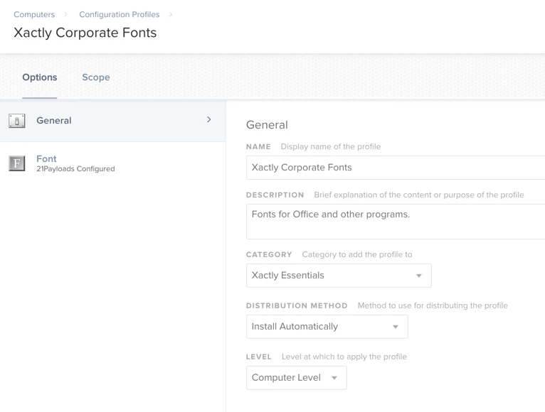

We also push corporate fonts using a Configuration Profile - it's very easy. Create the profile, click the "Font" payload and upload the fonts you would like to distribute. Using a configuration profile also means you can update the fonts later on, should they chance or you wish to add more to the list.
daniel_ross
Forum|alt.badge.img+20
  • Aug 22, 2018 2:38 PM UTC

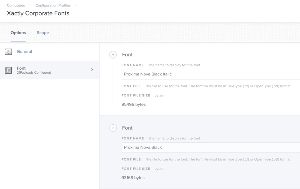

@jtrant beat me to the reply @drewsanderson but yeah we have 21 corp fonts loaded into the profile and they all then get pushed out to various machines and if we add more its as simple as just adding the new one to the profile and pushing out the change.
I attached the images below for you to see how we have it set up.
  • Aug 22, 2018 2:50 PM UTC

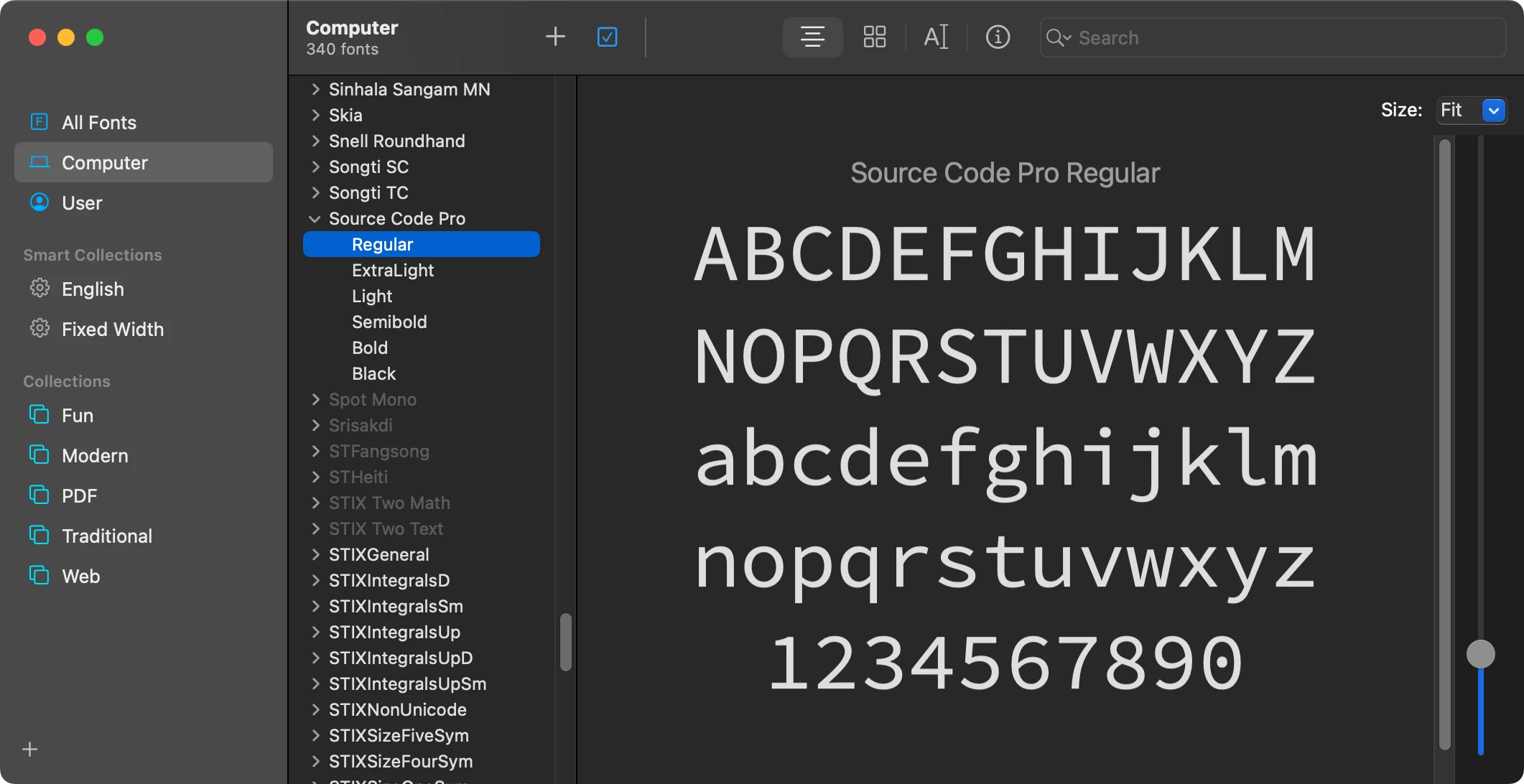

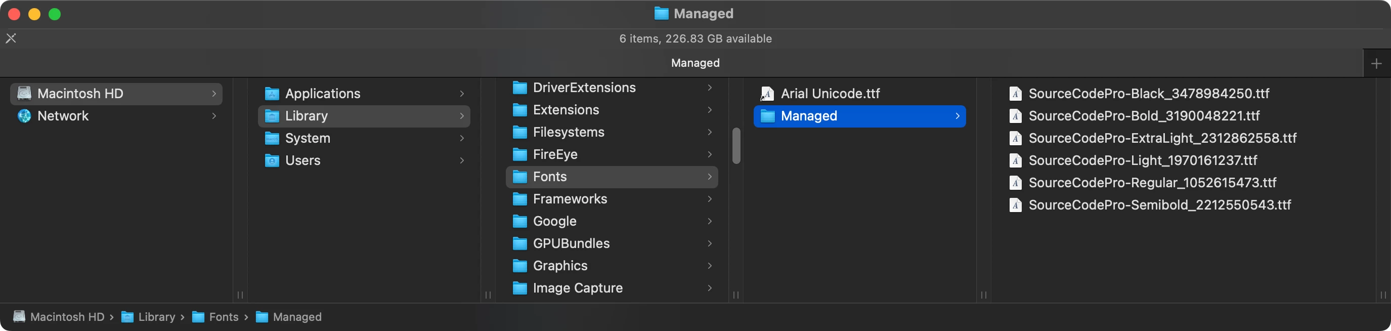

  • Sep 7, 2022 1:30 PM UTC
Out of curiosity, seems the Managed Fonts are placed here, and the hash(?) is only on the file. Font Book shows the proper info.
