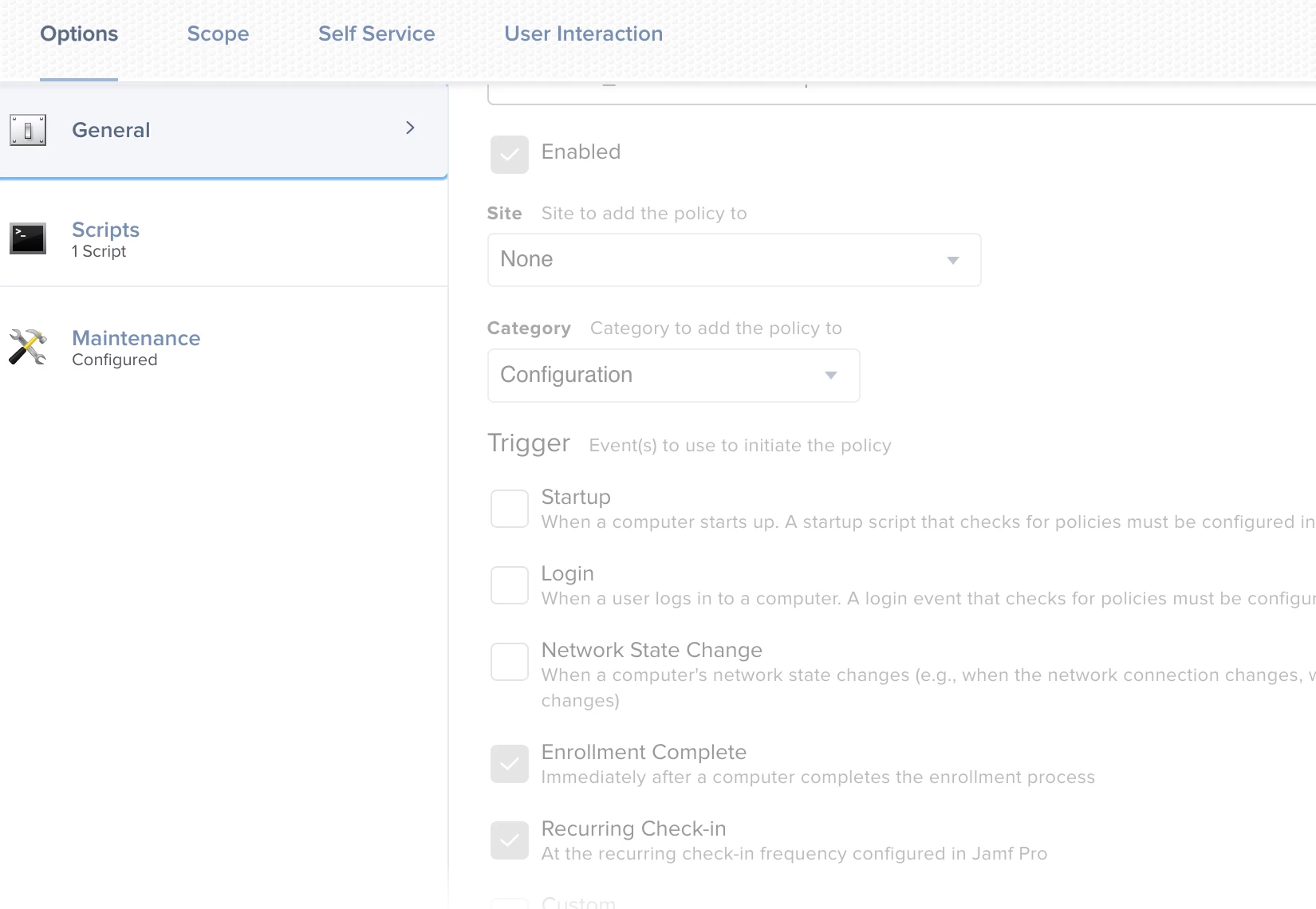

Weird...For some reason the policy doesn't want to execute after enrollment or at any check-in. I have the policy set up correctly, I think. I even put "*" in front to make sure it executes first but it skips right over it. Thoughts?
Ismere
  • Jun 16, 2023 11:07 AM UTC
What are the Triggers and the Scope you are using?
Our biggest Problem at the beginning was to Scope to a Group that was not filled when the enrollment complete Trigger happend.
If the Policy is not executing at all there should be no log viewable via Jamf.

So, I have a test area at my office with lots of machines, we have a smart group for them. I basically scoped it to that group and excluded all the other machines except the one I am about to enroll. Triggers are check-in and enrollment. I was checking the policy logs of the machine in question and saw that it isn't executing the policy at all.

I don't think it is a scoping issue. For every machine I test on, it shows up in policies in scope, just doesn't execute. It's so weird, because it's just a policy with a script. If the policy is in scope, theoretically, that means it's enabled and will be installed at whatever the next trigger is.
Ismere
  • Jun 16, 2023 11:26 AM UTC
One of ours is looking like this, the maintenance Task is to update the inventory.
If it is a script Issue then JAMF would try to execute the Policy and creates a log entry.
paramters for the script is param 4 account and param 5 password
Does it matter if the script runs "before" or "after"?

and mine looks exactly the same, inventory update too.
Ismere
  • Jun 16, 2023 11:31 AM UTC
running as before. since the inventory collection should be the last action. normally for newer systems you would like to use the Bootstrap information from Jamf after it is created.
Just to make sure you are using the Script that is published here or the newer one?

I am using the one mention in this thread. But that shouldnt matter as the policy isnt even running.
Ismere
  • Jun 16, 2023 11:37 AM UTC
that was just me asking out of curiosity for myself...
beside that. do you have any access to the machine? if so you could check the local jamf log of the testing machine under /var/log/jamf.log
For testing issues triggering a check-in via terminal to view the live feedback is also an option.
