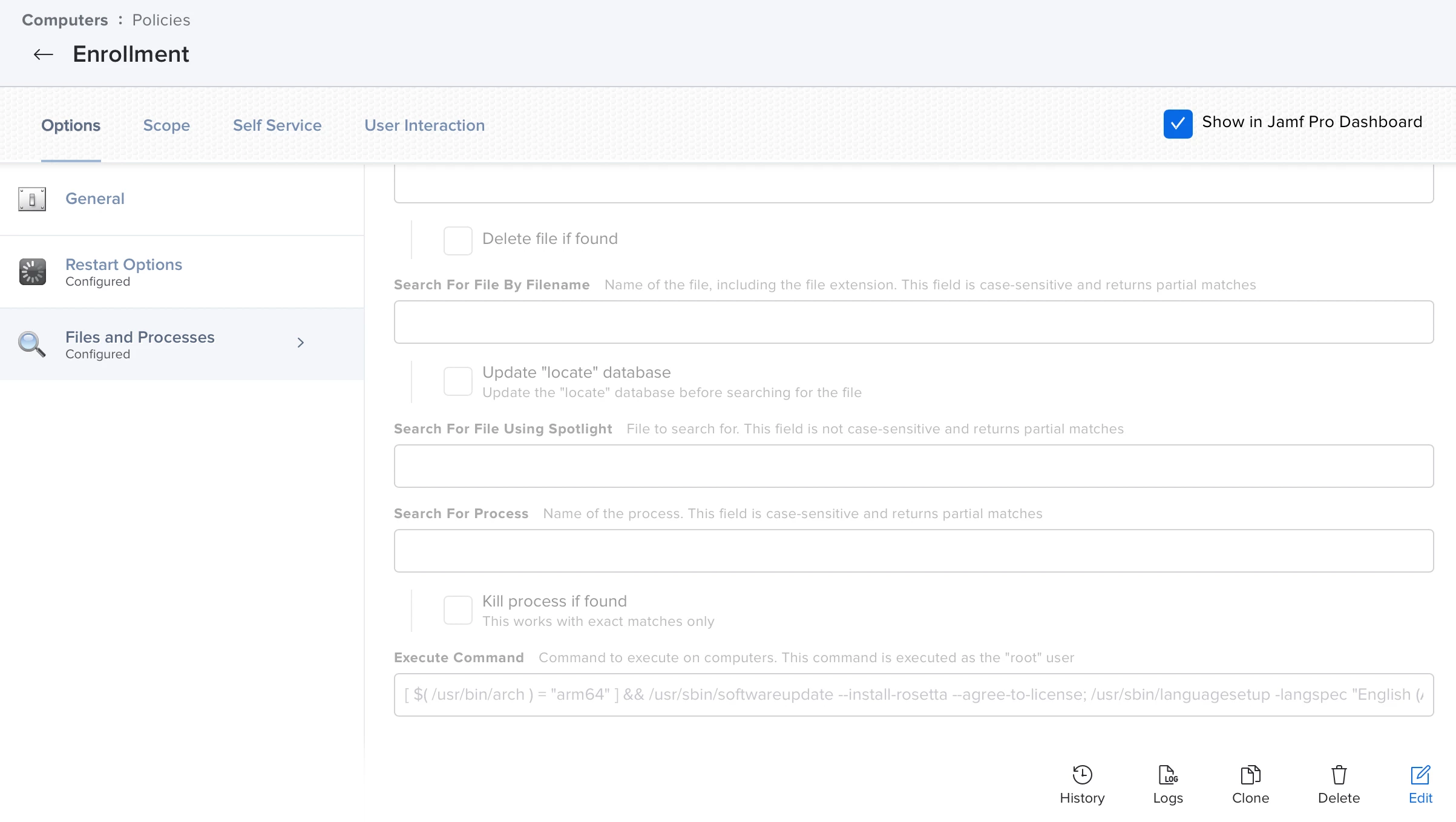

  • March 23, 2022
- One policy triggered on Enrollment Complete (using the restart and files & processes payloads)
[ $( /usr/bin/arch ) = "arm64" ] && /usr/sbin/softwareupdate --install-rosetta --agree-to-license; /usr/sbin/languagesetup -langspec "English (Australia)"; /usr/sbin/systemsetup -settimezone xx/xx -setusingnetworktime on -setnetworktimeserver xx.xx.xx; jamf setComputerName -useSerialNumber; jamf policy -event XXX
Works great. After the reboot I have a few more policies on startup trigger (boostrap escrow, enable ARD / Kickstart etc.) then finally check in trigger for software install. Done
