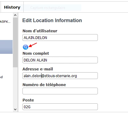

Bonjour,
Nos élèves vont changer de classe à la rentrée (Rubrique "Poste" sur la capture ci-dessous) et nous aimerions savoir s'il était possible d'actualiser automatiquement la recherche LDAP d'un utilisateur (et donc de sa nouvelle classe) sans être obligé d'appuyer sur la petite loupe?
Vu qu'on a plus de 800 utilisateurs... ;-)
Merci

is this on Macs? Or iOS?
On Macs, you can use recon to update any portion of that information if the user's name is on the local computer. I don't know a way to tell the JSS to re-run the LDAP lookup without clicking the magnifying glass.
I have a script that looks at the login history of a computer, picks the user with the most logins, then looks the user up in LDAP and runs the command below. However, if you don't have the assigned user on the workstation, I'm not sure how to get the JSS to update...
jamf recon -endUsername "$mainUserFound" -realname "$userFirstname $userLastname" -email "$userEmail" -position "$userPosition" -phone "$userPhone" -department "$userDepartment" -room "$userRoom" -building "$userBuilding"

This is for iOS. Is it the same script?

Personne pour m'aider?

The JSS does not have the functionality you are asking for. With Mac, you can get around it with a script such as I mentioned above. For iOS, there is no solution.
I recommend a feature request. There may be one already. Perhaps this one?
https://jamfnation.jamfsoftware.com/featureRequest.html?id=3533

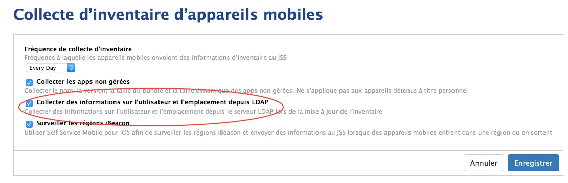

Bonjour Anastasiane,
C'est possible automatiquement, as tu vérifié dans les réglages > Gestion des appareils mobiles > Collecte d'inventaire
Que la case : Collecter des informations sur l’utilisateur et l’emplacement depuis LDAP soit bien cochée ?
Lors du prochain inventaire les infos seront mis à jours.
