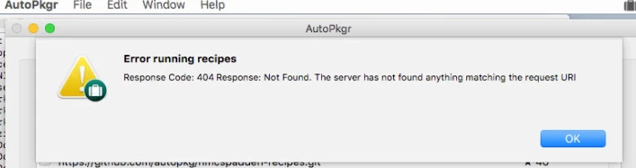

I bashed my head against it for some time, (coming up against several errors), I checked the system log and confirmed the package was being created locally, but could not see anything about it uploading to Cloud Distribution Point. Until at the end of the day I checked Jamf packages and saw that in fact it had been uploading the files despite throwing an error: "404 Response: Not found. The server has not found anything matching the request URI"
I am not sure what this error is; it originally occurred with all the recipes. But ran fine this morning, until I added another recipe and it replicated again. Any ideas what is causing this error?
