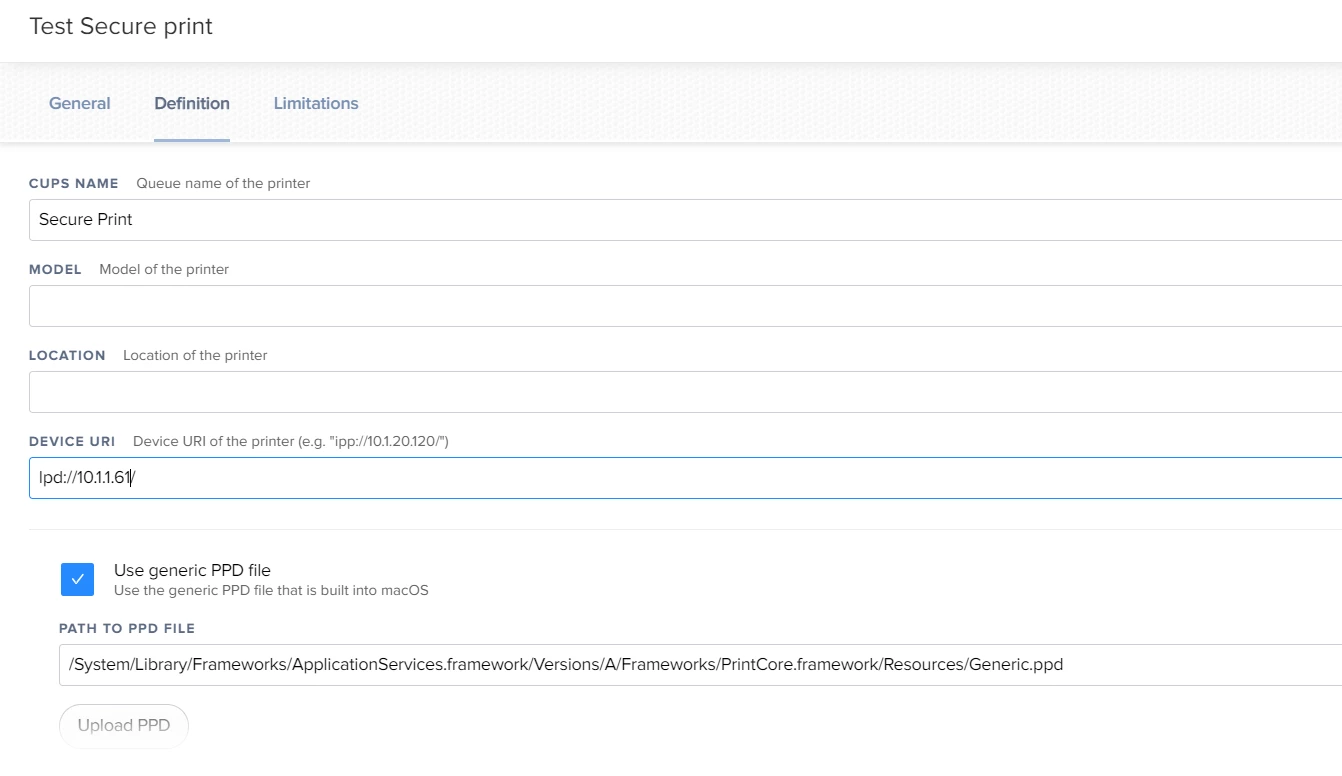

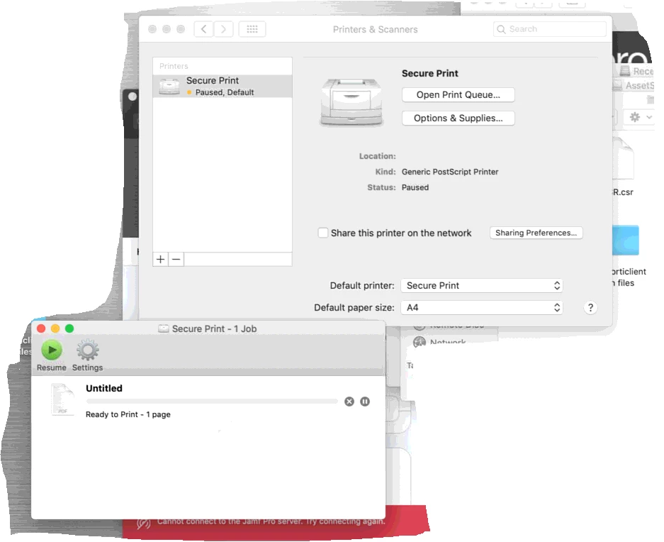

@tjhall thanks for that. I didn't really give full details.
So at the moment I have got the printer deployed to the macs, but when you send a print the print queue goes to "pause" and even if you click on resume, it spins and goes back to the pause state. I can add print queue manually to the macs going through settings etc and when you print it sends the job to the printer and the user access it ok using their badge. However I just cannot get it to work the same when deployed via jamf

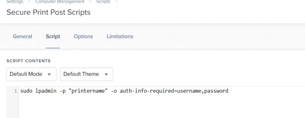

  • June 3, 2019
@bodeo And is that installed with a post script that authenticates?
It requires an authentication for it to work (printername needs to be the same as the custom queue)
sudo lpadmin -p "printername" -o auth-info-required=username,password

@tjhall no it isn't installed with a post script. I just literally fill up the printer detail in "Printer" and deploy it as a policy

  • June 4, 2019
@tjhall no thats tthru PaperCut. the ip address on the screenshot is to the papercut queue server.
when I run lpstat - s i get the following:
system default destination: Secure_Print
device for printername: ///dev/null
device for Secure_Print: lpd://10.1.1.61
One thing of notice is that there is an "_" added to the name which shouldn't be there.
As i said previously, when I setup the printing on a mac manually using the settings, the PaperCut secure printing works perfectly, I just go to any of the printers and use my id card to release the print.

  • June 4, 2019
  • June 4, 2019
@bodeo ] Yes, in your case it would be: sudo lpadmin -p Secure_Print -o auth-info-required=username,password
The user should be prompted to authenticate the first time they print (or after the click resumne).
Might be work right-click and "reset print system" in system prefs/printers first (or lpstat -p | awk '{print $2}')

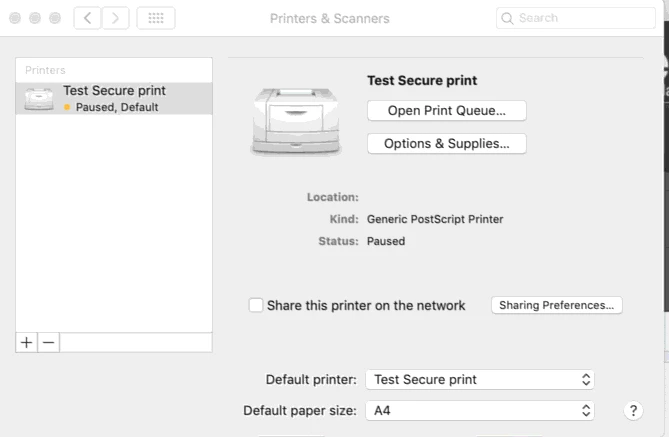

  • June 4, 2019
@tjhall should the fact it is "Secure Print" and not "Secure_Print" matter then?
  • June 4, 2019
@bodeo It needs to be the exact name (whatever name you've given the print queue) otherwise it won't work.
So usually whatever the system default destination is of lpstat - s
  • June 4, 2019
@tjhall I know but it seems the system is changing the printer name to Secure_Print instead of Secure Print and noway in the deployment have I named it Secure_Print
  • June 5, 2019
@bodeo So what did you name the volume share? I'd say it's probably better to name it Secure_Print than having a space in the name.
