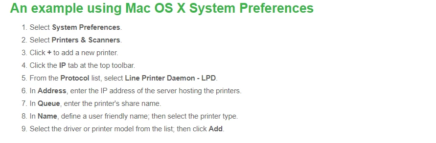

@tjhall @mainelysteve @Chris_Hafner thanks guys for your comments, will try those and let you know. I am very new to Jamf we only just started using it and am still trying to figure things out. We primary have windows pcs and just about 25 macs.
The puzzling thing is that when I setup the printer via below, it works but not when deployed thru Jamf. I suspect the issue might be because the secure print share name has a space in it.

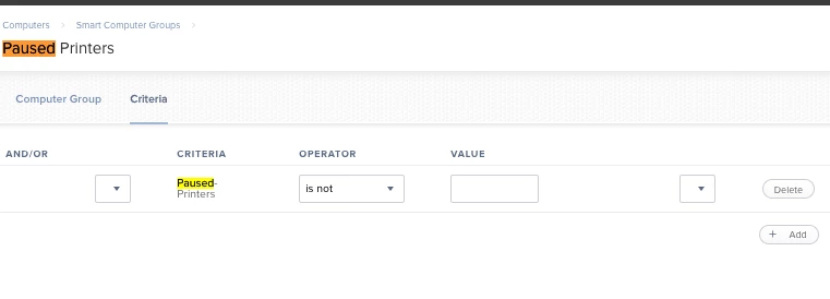

@Chris_Hafner can you explain how to create the smart group that tracks paused print queue

@bodeo Listen to @mainelysteve and use DNS names. As for the scope question.
1) Create an Extension Attribute with the script I included above
# echo $(lpstat -p | grep -EB1 "Paused")
# echo $(lpstat -p | grep -w "disabled" | awk '{print$2}')
RESULT=$(lpstat -p | grep -w "disabled" | awk '{print$2}')
echo "<result>$RESULT</result>"
2) Create a new SMART group as follows: CRITERIA of "NAME OF EXTENSION ATTRIBUTE"
OPERATOR: "is not"
VALUE: (leave blank)
It should look something like this:

@bodeo Just to verify as your screenshot above shows you didn't add the printer share name to the URL field. So it should be lpd://servername/printer_share. It's probably pausing because of this config error.
You should check cups in your browser:
On the mac your testing with enter localhost:631 into Safari or whatever your favorite browser is. Click Printers and if prompted enter the command shown into terminal. Back in cups click the queue name created by the jamf Pro policy and ensure the connection field has a fully flushed out url and not just the print server address. If the queue/share name on the print server has spaces in it please use (-) dashes i.e. Office Printer should be entered as Office-Printer.
You may also have issues with the generic ppd you're using.
Again you may have already done this but I'm double checking as your previous posts show that jamf is sending out the incorrect url.
