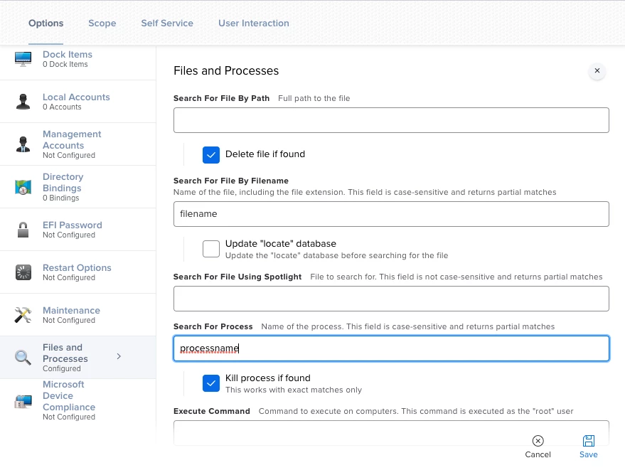

You can try "Files and Process" payload of policies.
I want to make a Smart Group based on if a file is found on a device, but how do I use a policy that searches all computers for a file to do that? It seems the only results produced are in the Log -> details of the policy.
