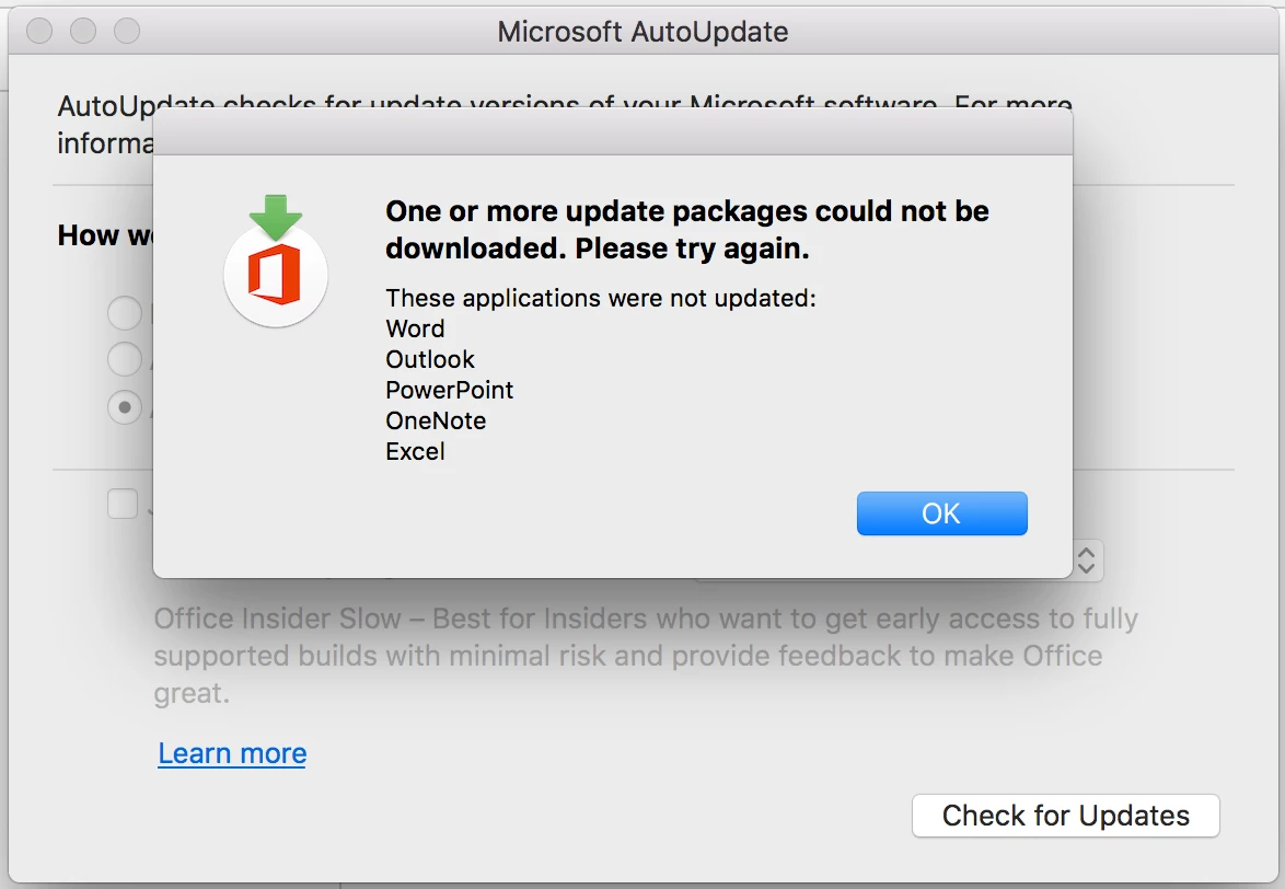

I've updated the MAU clients to v. 3.9, and now we can't download updates from the MAU Caching Server. We keep getting this error:
EDIT: Never mind. I didn't give the server enough time to download the updates. They're all in now, and we can download.

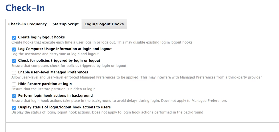

@neil.martin83
Are there any particular tricks to getting login policies to run ?
I just created a policy with the Trigger = login, Frequency = ongoing, Make available offline is checked.
Double checked that Management Settings > Check - In > Login/Logout Hooks has Create login/logout hooks checked.
I've logged the user out and in a few times and also ran recon incase that's needed to pull down the script initially but if i check the policy logs it's still shown as pending.
Should i see something from the Policy within /Library/Application Support/JAMF/ManagementFrameworkScripts/loginhook.sh ?
(i can see that com.apple.loginwindow has this set as the LoginHook),
and will login hooks only run if the Mac is on the network ? (i was assuming that the Make available offline option would mean network wasn't required)
JSS 9.96
OS X 10.11.6
