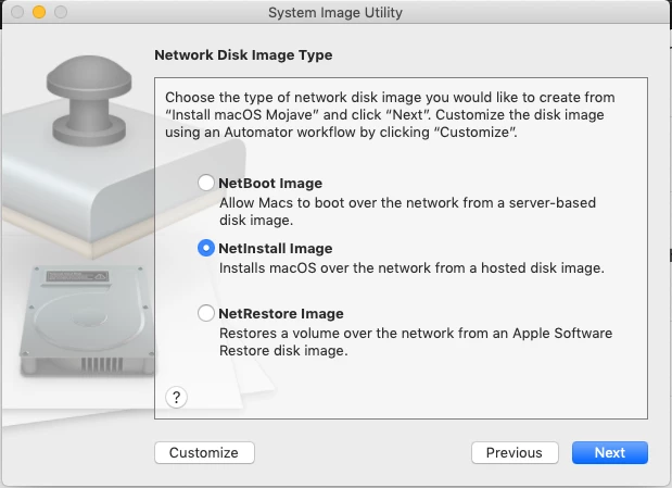

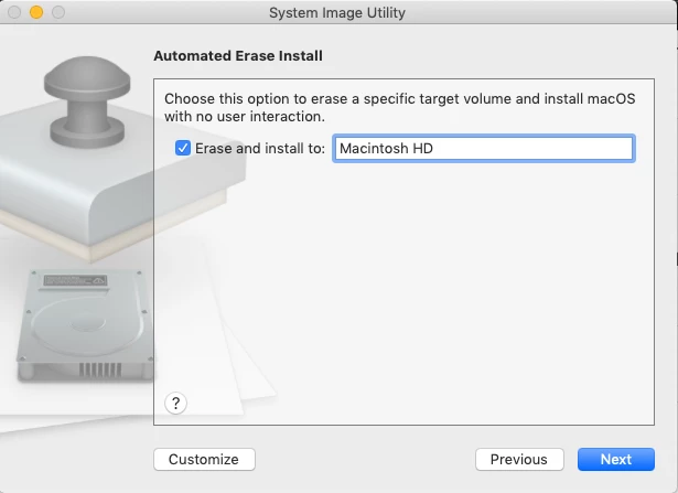

@sharriston Would you be willing to share how you created the Netinstall image that wipes and restores 10.14?
Sure in System Image Utility I select NetInstall Image then about three clicks later I check off Erase and Install to target volume and enter Macintosh HD. Then I just host the nbi file on my netboot server.
Granted if the Macintosh HD has been renamed it will just be a normal NetInstaller and you need to actually click which volume you want to erase but this method has been working ok for me when we redeploy a machine. Hopefully it will become like iOS soon where the base OS is on it's volume and you can just click remove all user data to start over.

@sharriston I used the System Image Utility before posting, pointed to the Mojave Installer, created the NetInstall image and when I boot my Mac Mini to it -- it shows spinning world loading the NetInstall, then it shows Apple logo with progress bar and that will be fully loaded but never do anything....Have you seen this?
@sharriston I figured it out -- under the settings of the NetInstall Image -- it was made available over HTTP -- I set it to NFS like all my others and it's working :)
