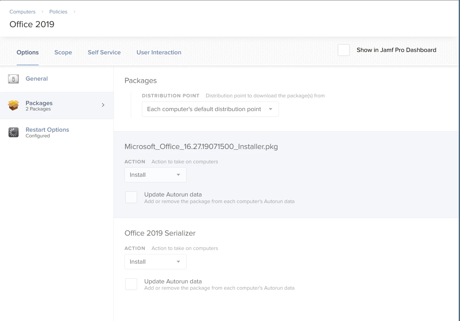

Here is our policy, sweet and simple. It doesn't update inventory because it runs as part of DEPNotify, which will recon at the end of the "imaging" process.

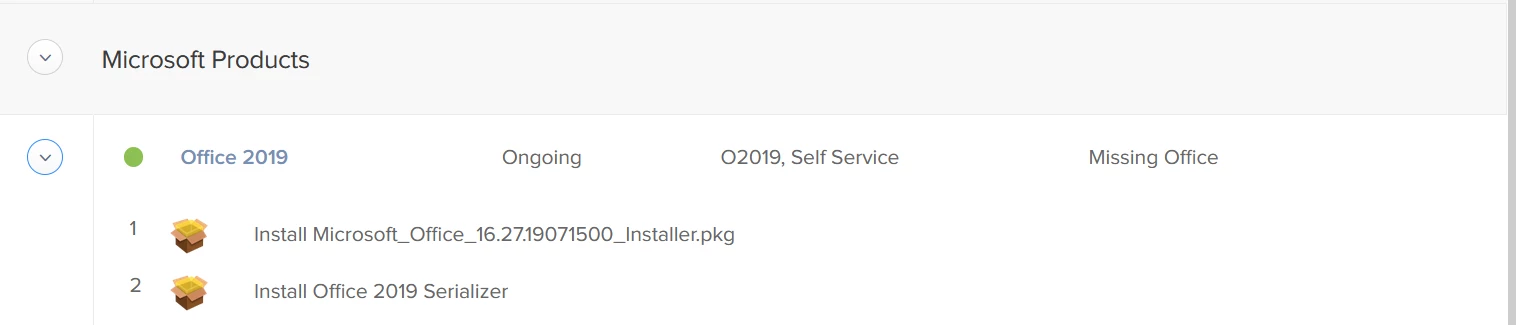

I'm on the super granular, Individual policies for everything and anything that needs deployment train. As stated by others above...
1 Policy, 2 Packages.
MS Installer - Deployed 1st
MS Serializer - Deployed 2nd
Done Deal. Easy to swap out the package on the fly to the latest version of ms office.

@CorpIT_eB
The workflow is likely the same, if not similar to the image I posted above.
Make a policy -> add the Office Installer -> add the Office Serializer -> Scope it
and it will install Office first, then serialize the installation.
If you want to deploy a new version of Office 2019, just upload it to the JSS, go to your policy and select the new Office pkg.
I like to delete both packages from the payload and reselect Office 2019 and then the Serializer just so I know it executes in the proper order: Office -> Serial license
