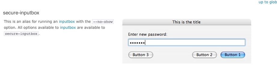

I've never used it in this context, but I have been recently working with the cocoaDialog. Here is the link to the github:
http://mstratman.github.io/cocoadialog/#documentation
There are some nice options for interacting with the users, including a secure input box, which you may be able to use to prompt the user to put in their password.
Again, I haven't used it for a script like this, but it may be of some help.

  • April 22, 2015
@jennifer_unger Thanks man you save me

Thanks @jennifer and @kenho794
This is my final script i would like to share:
# Created By: Thijs v Vught
# Creation Date: November 2015
# Last modified: November 13th, 2015
# Brief Description: Mounts QNAP disk to your MAC (With cocoaDialog)
# Set CocoaDialog Location
CD="/usr/local/bin/cocoaDialog.app/Contents/MacOS/CocoaDialog"
itest=$(ping -c 1 10.12.232.100 | grep "100.0% packet loss" | wc -l)
while [ $itest == "1" ]
    do
    sleep 5
done
sudo tmutil enable
pw=($($CD secure-standard-inputbox --title "QNAP TimeMachine" --informative-text "Enter password:"))
password=${pw[1]}
sudo tmutil setdestination afp://TimeMachine:$password@yourdnsname.nl/TMBackup
$CD ok-msgbox --title "QNAP TimeMachine" --text "Timemachine Disk is Mounted"
