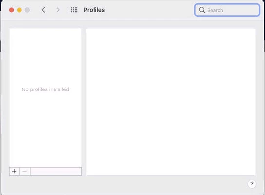

Ok, where do you start with Big Sur?
Most packages install fine, we have issues with Configuration Profiles being stuck in a pending state.
No System Preferences/Profiles dialog.
Opening Self-service constant request to Approve MDM Profile every time this app is opened, click the link and goes to the System Preferences/Profiles but just a blank dialog box (see image below)
Big Sur 11.0.1
Jamf 10.26
