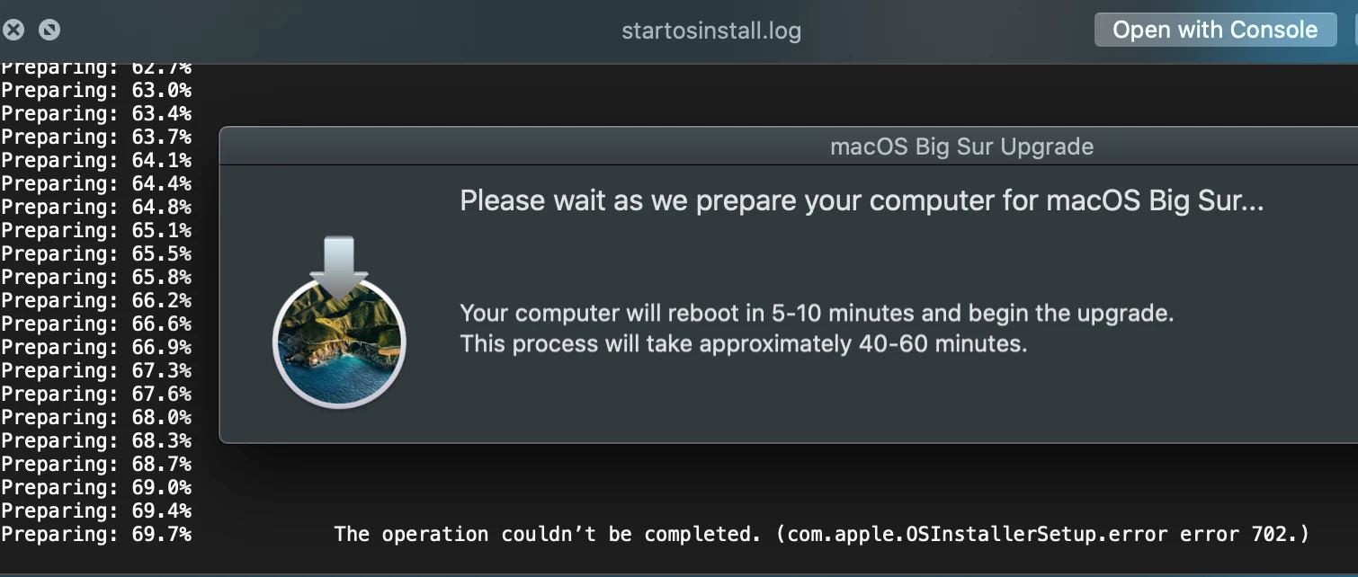

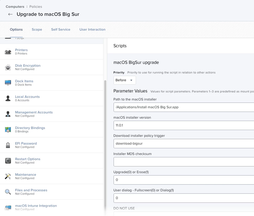

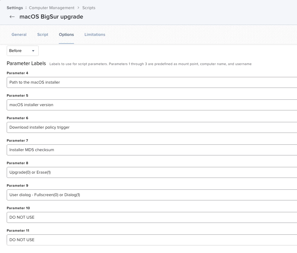

I've changed the script @AJPinto mentions to this.
It's a bit dirty, but it works (for now).
There is a separate policy to download and install a DMG with the Big Sur installer from JCDS.

## Specify path to OS installer – Use Parameter 4 in the JSS, or specify here.
## Parameter Label: Path to the macOS installer
## Example: /Applications/Install macOS High Sierra.app
OSInstaller="$4"
## Version of Installer OS. Use Parameter 5 in the JSS, or specify here.
## Parameter Label: Version of macOS
## Example Command: /usr/libexec/PlistBuddy -c 'Print :"System Image Info":version' "/Applications/Install macOS High Sierra.app/Contents/SharedSupport/InstallInfo.plist"
## Example: 10.12.5
installerVersion="$5"

## Custom Trigger used for download – Use Parameter 6 in the JSS, or specify here.
## Parameter Label: Download Policy Trigger
## This should match a custom trigger for a policy that contains just the
## MacOS installer. Make sure that the policy is scoped properly
## to relevant computers and/or users, or else the custom trigger will
## not be picked up. Use a separate policy for the script itself.
## Example trigger name: download-sierra-install
download_trigger="$6"

This script works with the following script options in Jamf.
The script check for a local installer first and if found it skips triggering the download policy.
The selection to either Upgrade or Erase and install can be made in the options as well.

Getting 702 error at 69% and it's taking too much time approx 50 mins to reach 69%. I ran twice but same error while reaching at 69%. Don't know what the cause is.
