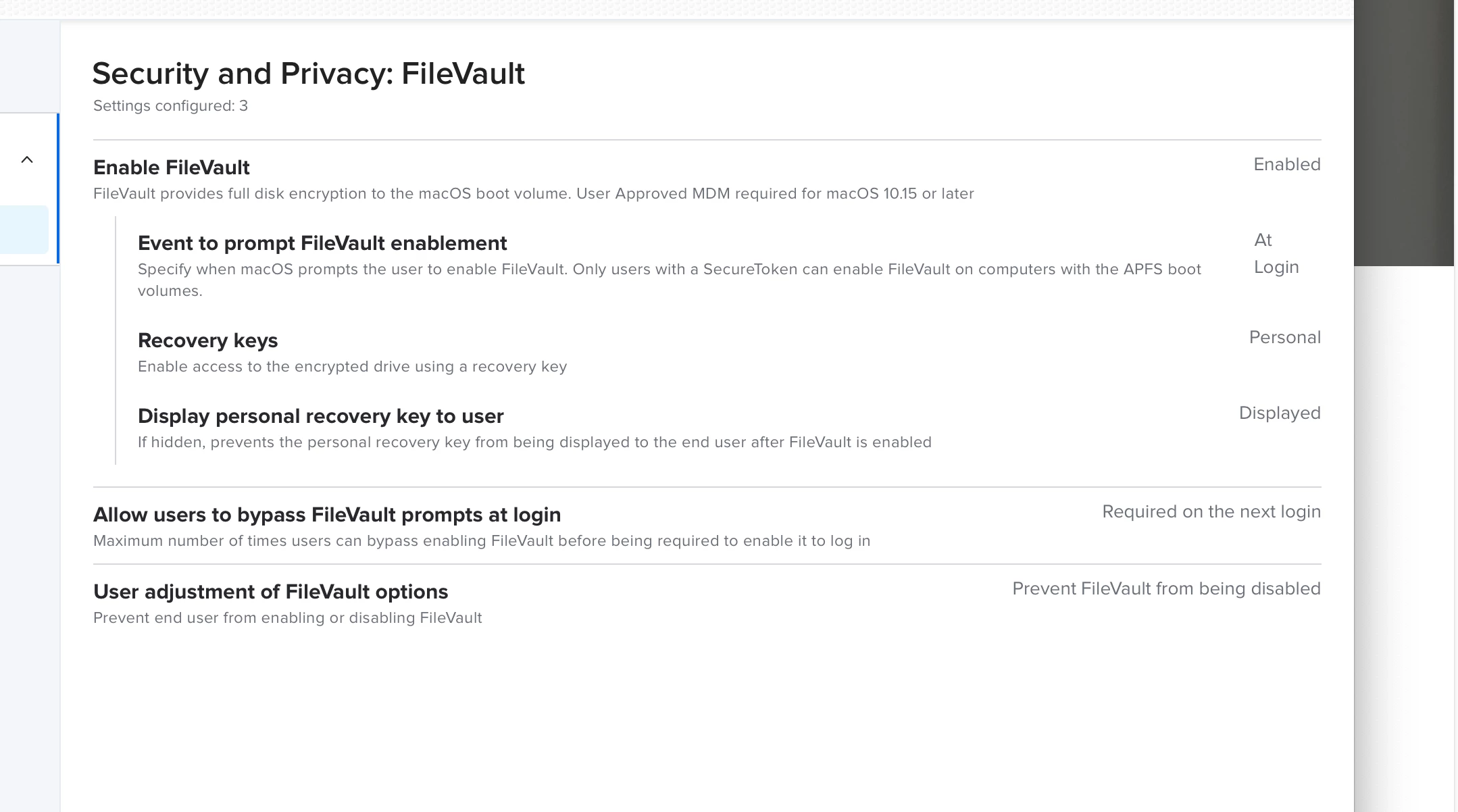

We are starting to implement JAMF and a lot of end users have their FV2 key linked to their personal iCloud account.  With most machine already on Big Sur.  Has anyone had a successful way of re-issuing FV keys and escrowing them to JSS?   We have  these settings enabled, but on new computers it doesn't seem send the key to JAMF. We would like to also move the existing FV keys and escrow to JSS

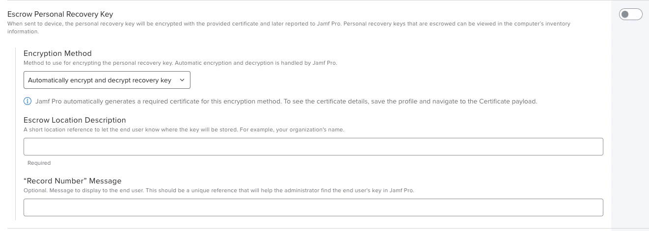

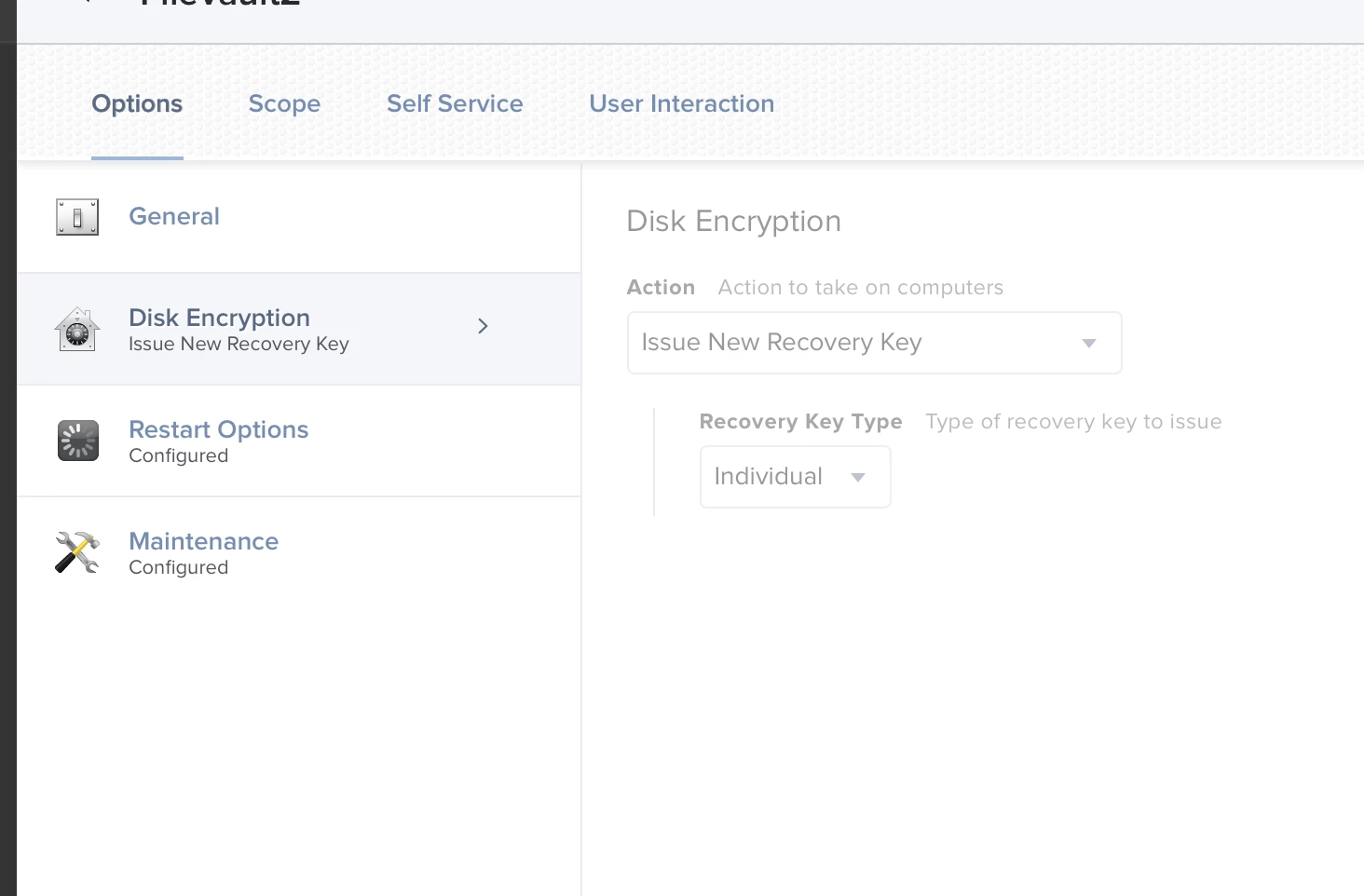

If the device is already setup and encrypted, you'll need to prompt the user for their password in order to generate a new key that will then be escrowed. This would be a good start.

You'll need to use the "Escrow Personal Recovery Key settings:  I just used this method and escrowed a key on Big Sur.

Have a look at https://github.com/jamf/FileVault2_Scripts/blob/master/reissueKey.sh
I'm using this and it's working fine on Big Sur Macs...caveat being I have no M1 to test, only T2's...

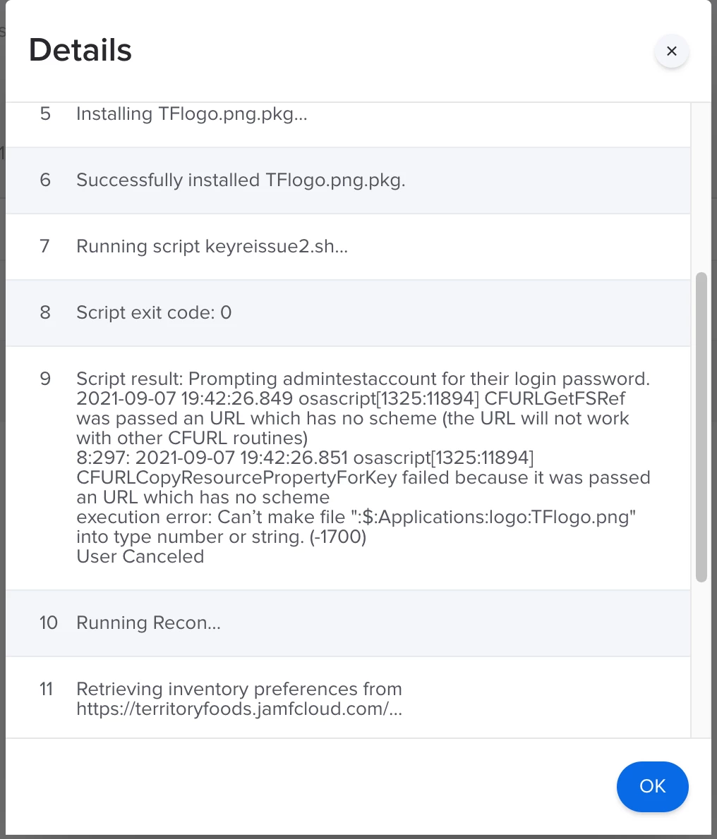

I just attempted running the script on a test machine and got the following result.  Any ideas?
Would have to see what your script looks like, but I'm going to guess that when you are defining the location of the TFlogo.png, you may have some illformed code based on the "Can't make file ":$:Applictions:logo:TFlogo.png" part of the error message.
Thanks for responding, I got it working last night.  Seems it did not like the file path I added in for our company's logo once I added file :// in front of the file path it worked like a charm.
