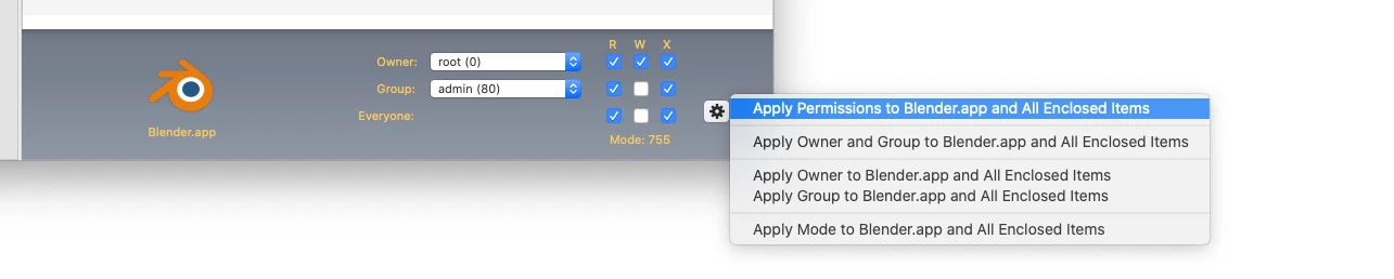

Hi, sorry for the late reply. I try to avoid using snapshots as much as possible as it can include unintended folders and files. I installed blender (drag and drop) on my test/build machine. I then ran the below command from the terminal:
sudo find /Applications/Blender.app -exec chmod 755 {} ;
I then dragged the blender.app on to Composer and then I changed the apps file permissions in Composer so that they no longer referenced my logged in account as the owner. i.e. I changed the permissions on the app (in Composer) to Owner = Root and Group = Admin). I then clicked on the cog icon at the bottom right and selected "Apply owner and group to Blender.app and all enclosed items". I then clicked 'build as PKG' on the top menu.
Installing the resultant PKG onto a clean test machine allowed me to run the app correctly on multiple accounts without any error messages popping up about permission settings or no-entry signs on the Blender.app in /Applications.
I didn't have the other issues that you had. I think it's because you were snapshoting and I wasn't doing that. Composer supports app drag and drop instead of snapshot. My original post was incorrectly worded when I said 'capture'. I have changed it now to 'package'.

@Becci I actually found a better way of doing this since the original post.
Install Blender 2.83.3 LTS on your admin machine
Run it to remove quarantine prompts etc.
Drag and drop it into composer
Open the applications folder displayed in Composers right hand window
Click on the Blender.app to see its permissions
Set the Owner = Root and the Group = Admin
At the bottom right you'll see the app permission settings are set to 700 read write and execute for the owner only (by default). Change this to 755 by ticking write and execute for the Admin group and Everyone group.
Now click the cog icon to the right.
Click - Apply Permissions to Blender.app and All Enclosed items (this applies the permission fix within Composer without running any terminal commands.)
Click - Apply Owner and Group to Blender.app and All Enclosed items
Now build the PKG and it will work. That's what I've been doing for the last few versions.
