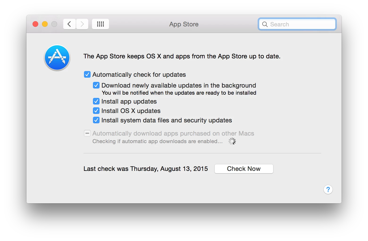

You could also have update checking disabled. To turn things off in the App Store preferences:
Automatically check for updates
defaults write /Library/Preferences/com.apple.SoftwareUpdate AutomaticCheckEnabled -bool false
Download newly available updates in the background
defaults write /Library/Preferences/com.apple.SoftwareUpdate AutomaticDownload -bool false
Install XProtect and Gatekeeper updates automatically
defaults write /Library/Preferences/com.apple.SoftwareUpdate CriticalUpdateInstall -bool false
Install system data files and security updates
defaults write /Library/Preferences/com.apple.SoftwareUpdate ConfigDataInstall -bool false
