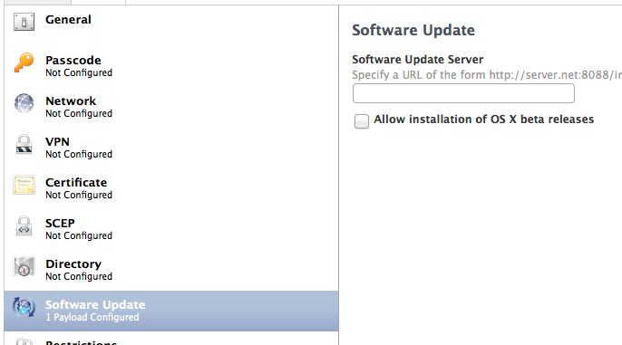

This is now built into Config Profiles that you can deploy from the JSS, but its tied in with the Software Update payload, so it would mean setting a SUS for your Macs and scoping appropriately. Make sure to uncheck the "Allow installation of OS X beta releases" box as seen below.
If doing this with a Config Profile isn't an option, you'll need to look at creating a specific profile with this setting. This can be done by making a plist with the one setting as @tkimpton posted above and converting it to a mobileconfig profile using mcxToProfile.

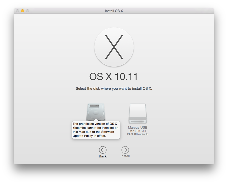

  • June 17, 2015
I have scoped the config profile as per the Apple kbase article and that works fine to restrict the installer in the Mac App Store. I decided to add Install OS X 10.11 Developer Beta.app to restricted software but that doesn't seem to be working. once I clicked through the installer however, I came across this when I got to selecting the drive. (note the wrong description of the OS)
