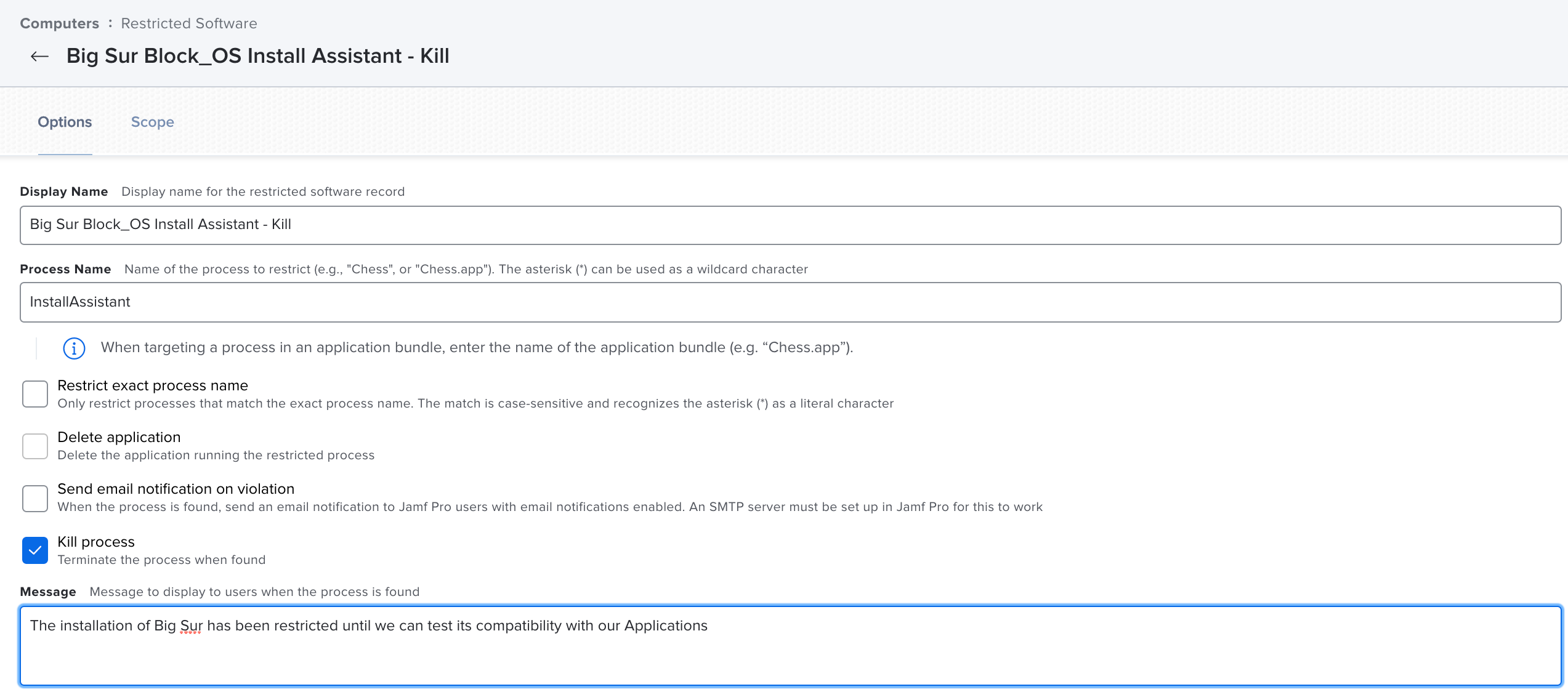

Hey guys, I found that I had an unchecked "Kill Process" which made a difference. We could also delete the application but decided we would need it later.
I also renamed the App to "Install masOS Install.app copy" and it did in fact stop the install.
WAHOOOOO!

  • November 16, 2020
@rhooper that process worked for me. Once it downloads completely and you launch it to install it blocks immediately. Works both from the Applications folder or System Preference when you click "Update Now". Does anyone know how to get rid of the notification to update as well? So it doesn't nag with that "1" on System Preferences.
  • November 16, 2020
@everhelst Yes, it does install it, but then blocks the installation of the app. You can also have it delete the application altogether.... but we may need to call upon it at another time in the near future.

You can set it to delete it after it downloads. However, that doesn't stop people from redownloading it over and over again plus its a hefty file size... I'd just leave it and restrict the opening of the .app file.

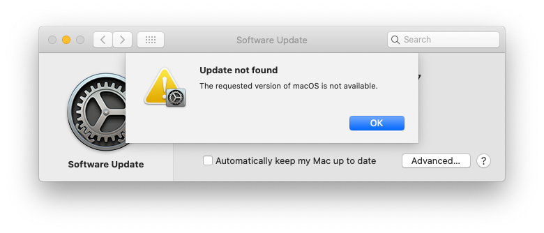

I do a couple of things to block it.
  1. I block the .app with restricted software and set it to delete the installer when run. This will get most users unless their savvy enough to rename the app.
  2. I disable the Big Sur update form even showing up in the native Software Update GUI with the command below. This will hide it until reset. So no prompts in native GUI no matter what they do. Even if you go to the Apple Store and try you get the attached message. Note that this command will no longer work in BigSur but works in Catalina down. So we will need to figure out something else for whatever surpasses BigSur. sudo softwareupdate --ignore "macOS Big Sur"
  3. We simply notify our users.. "hey, don't install this yet until we confirm our security agents and config are good. "
EDIT: @scottb we do a few things like requiring one of our Agents to use VPN, and network scans for unmanaged machines to fine those turkeys. When they can connect to VPN they call in crying. We re-enroll them. We also make tickets for the help desk to force them back to Catalina :)
