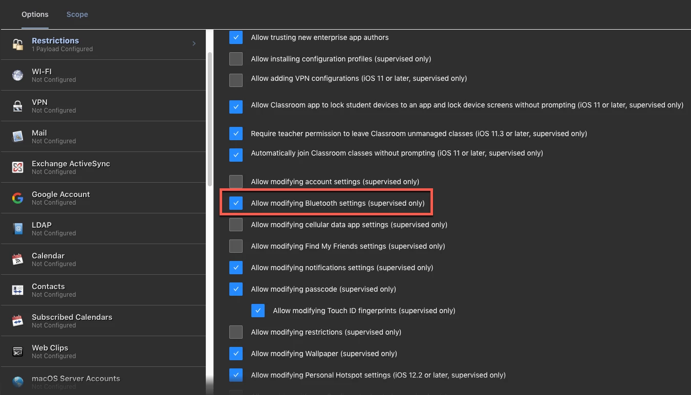

Might want to make sure that you don't have a configuration profile that is disabling them from modifying bluetooth settings.
Yes we do have that problem...do you know how to correct it?
Make sure that this box is checked.
Thank you so much!! That was our problem...
