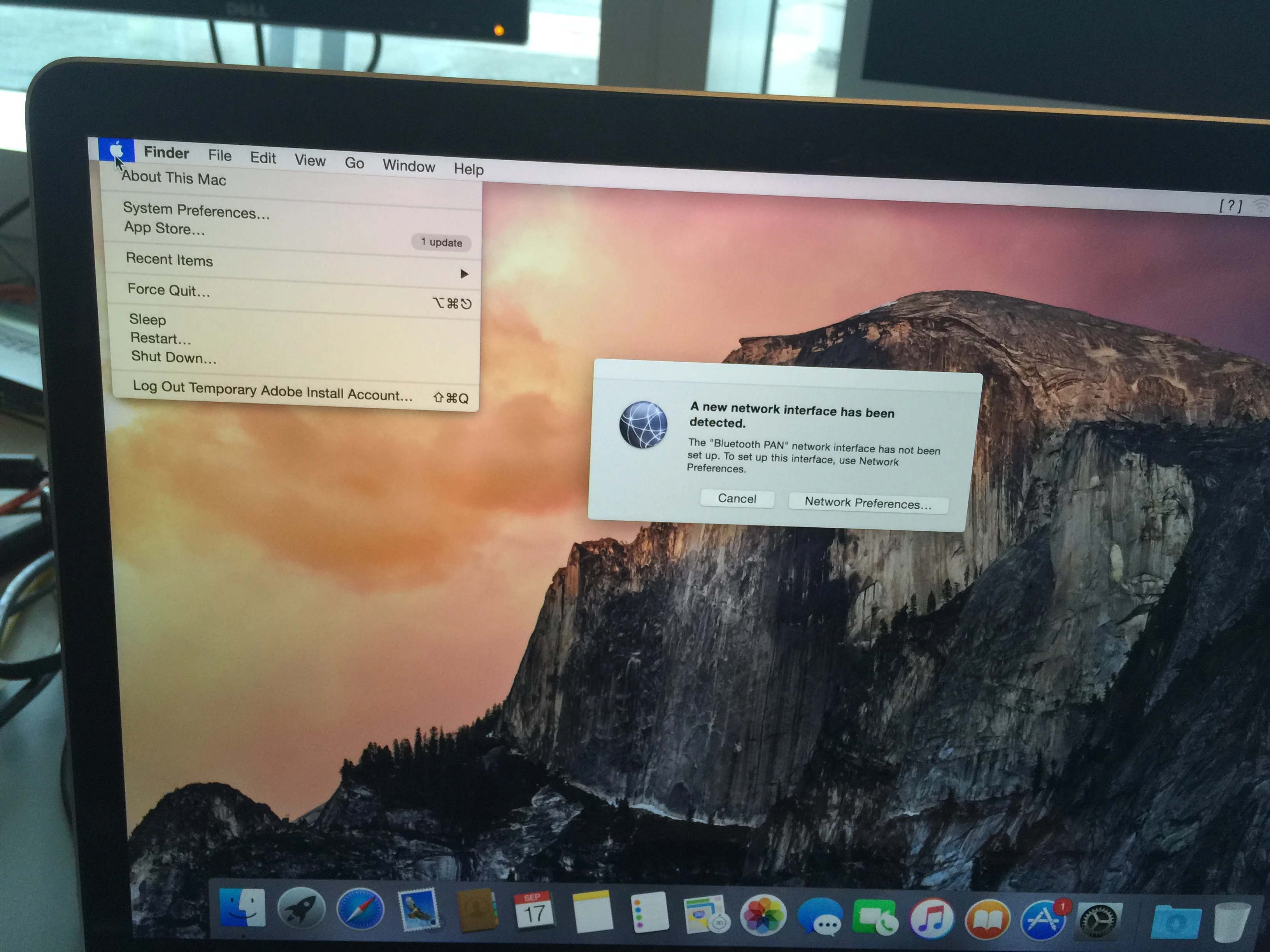

Tried to image a machine a machine (10.10.x, Casper 9.8) and when the machine reboots and goes into the "The imaging process is finishing installing software" screen, it sits there for a bit, and then that screen clears away and a popup window opens "A new network interface has been detected - The "Bluetooth PAN" network interface has not been setup yet....and it breaks out of the imaging process. Didn't have that problem yesterday when I was working on this, but today after updating to 9.8 I am.

Sorry, just to clarify: I am seeing this myself but on 10.10.5 with Casper 9.73. I'm seeing this on two MacBook Pros (2012 and 2013). Both having TB-Ethernet adapters.

I'm already doing that myself. But this is a false alarm. I thought that screen was holding up the network but it turned out to be something else entirely causing it. I do see that pop-up though, but it's not causing problems here.

I just started seeing this error from the original posting. Imaging version 9.98 & 10.12.4 but works fine with 10.12.3. It seems like when the bluetooth detection pops up, the imaging full screen goes away but the rest of the imaging process continues on. The machine auto reboots once the apps from my imaging process finish installing. Was there another work around for this? I wonder if anyone else has tried the process out since 10.12.4 has been released.

though I haven't had the issue since a much older version of casper imaging, I believe I made a package that contained this as a postinstall script, and had it run pretty early in the workflow.
/usr/sbin/networksetup -createlocation Default populate
/usr/sbin/networksetup -switchtolocation Default
/usr/sbin/networksetup -deletelocation Automatic
  • June 7, 2017
thanks @grepoli I'll consider adding this as well. For the meantime, I added a pkg with a 1 priority in the workflow that invokes the jamfhelper in a postflight script as described here
