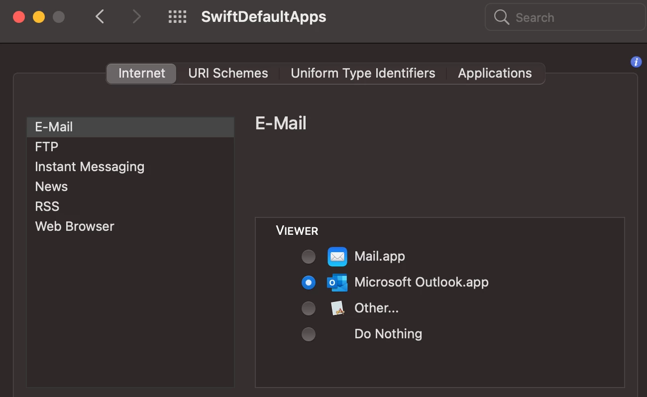

sdagley
  • Apr 26, 2021 1:38 PM UTC
@DMH2000 It sounds like you're still doing something that's launching Outlook directly rather than invoking it as the mailto: handler. The following works as expected for me on macOS Catalina with Outlook set as the default mailto: handler:
/usr/bin/open "mailto:test@somedomain.com?subject=Computer Information&body=Some random text for the body of a message"
If you copy and paste that line into Terminal on your system what happens?
DMH2000
  • Apr 26, 2021 1:48 PM UTC
@sdagley The file /Users/My.Name/mailto:test@somedomain.com?subject=Computer Information&body=Some random text for the body of a message does not exist. I should mention this is on Big Sur, but don't think that is the issue.
When I put type in /usr/bin/open "mailto:test@somedomain.com?subject=Computer%20Information&body=Some%20random%20message" a new message opens...
sdagley
  • Apr 26, 2021 2:01 PM UTC
@DMH2000 Why your Mac thinks it needs to open a file with the contents of the mailto: URL is the mystery that needs to be solved. What does a simple /usr/bin/open "mailto:" do? It should open Outlook with a mail compose window.
DMH2000
  • Apr 26, 2021 2:29 PM UTC
@sdagley. It opens a message window. As I edited the message above: When I put type in /usr/bin/open "mailto:test@somedomain.com?subject=Computer%20Information&body=Some%20random%20message" a new message opens...
