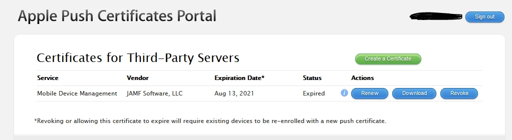

  • August 17, 2021
@ACurnow_LU
Thanks for sharing this solution. I just had this mishap where I used trhe wrong ID for the first time.
I have since uploaded the newly generated APN with the incorrect ID back to our JSS and am wondering now (since I now know the correct ID and have access to the APN portal) how to go about reverting this before we hit the APNs error that you saw (its only been 4 days since expiry).
The macOS environment seems okay for now but the iOS devices are already starting to hang when I try and download anything via Self Service app. Thje topic ID is definitely different so thats confirmed.
From what you have written, you say to go and just generate it using the correct ID but it is asking for a Vendor signed CSR file which I believe you get from the JSS (which now has the incorrect ID APN).
SHould I just go through the process anyway and hope the original ID created APN prevents the need to reenroll our devices again?

Hey @Ke_ReM, while for us we went ahead with swapping the certificate and re-enrolling our devices, I believe if you generate the APN Cert using the original ID, you shouldn't need to do so.
The Vendor-signed CSR file is the same either way as far as Apple's concerned, it just needs to know which Vendor is looking to make use of their APN service.
Ke_ReM
  • August 18, 2021
Yep can confirm, I bit the bullet last night and went ahead and renewed the APN in our JSS regardless of the fact I had already renewed it with an incorrect ID as I knew time was critical and ticking.
It basically overwites and the Topic ID's become the same as they were originally which means the existing managed devices are recognised and do not need to be re-enrolled.
Happy days.
