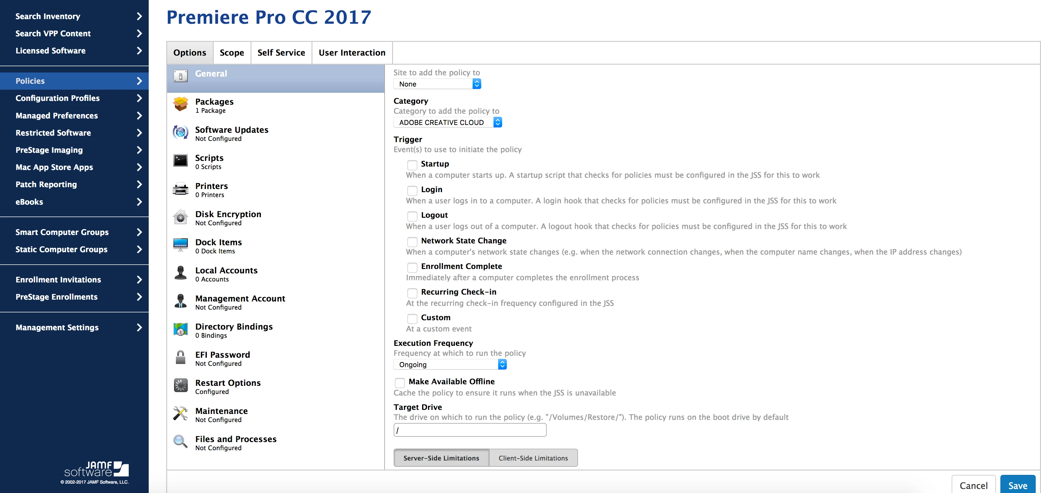

Issue: The system will not let me set it the execution to Ongoing with a Trigger of Recurring check in Scoped to All computer, because of the update inventory payload.
here is the error message: "Policies that update inventory on all computers cannot be set to ongoing frequency at recurring check-in."
sdagley
  • July 31, 2017
@casper.admin Do not scope the Policy to do the Cache to all computers, do it to a Smart Group of computers that don't have the software installed and exclude the computers that have the package cached already.
For the policy that does the Install Cached, the only trigger should be the Custom event, and you don't need an Inventory payload on that policy since the one from the Cache policy will execute after the Install Cached policy is called.

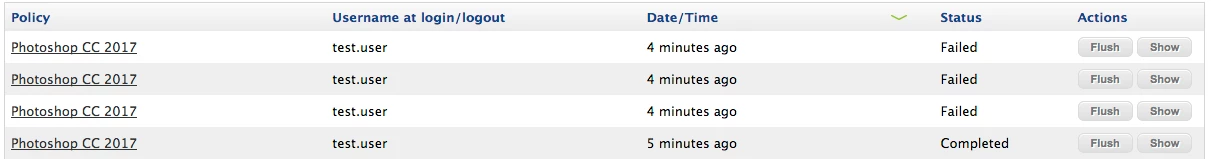

Everything is set up and running, but am getting a Failed Status on the Install Cache because the policy tries to run again 3 times after the initial install, then fails because the cached packages is not there anymore after installation complete. So I get 1 Comptete and 3 failed status.
See picture:
I have update inventory in both Cache and Install Cache policy.
sdagley
  • July 31, 2017
