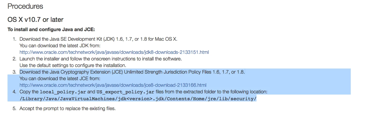

Do you have the Java Cryptography Extension (JCE) installed as well?
Installing Java and MySQL

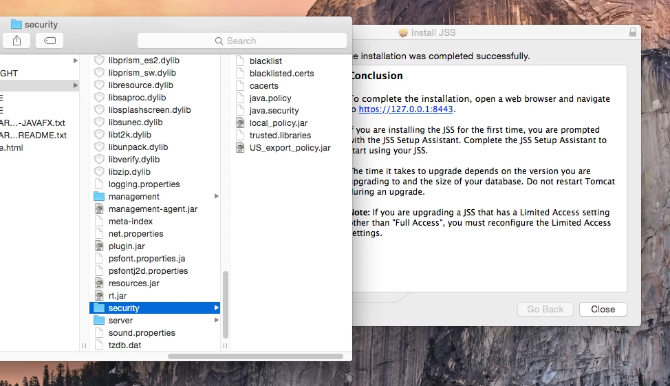

@jennifer
Yes, everything listed is installed. The webpage still doesn't want to load.
