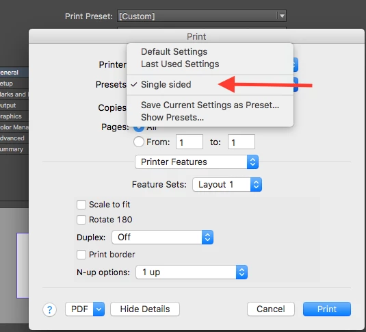

So I made a printing preset to do single sided printing as highlighted in the screenshot below:
I found that the preferences lives in /Library/Preferences/com.apple.print.custompresets.plist
However when I package that plist up and try pushing it to other machines it doesn't give the target machine the printing preset for some reason. What am I missing here? Is there a better way to do this?
Thanks in advance for any help you can give!

  • September 22, 2016
Following...also struggling with this.
  • January 11, 2019
I'm reading below that presets are stored in ~/Library/Preferences with the name com.apple.print.custompresets.forprinter.<name>.plist
See discussion here:
https://apple.stackexchange.com/questions/171198/copying-printer-preset-plist-files-mavericks
So populate home directories with FUT/FEU when you deploy. Makes sense, as a per-user setting.
