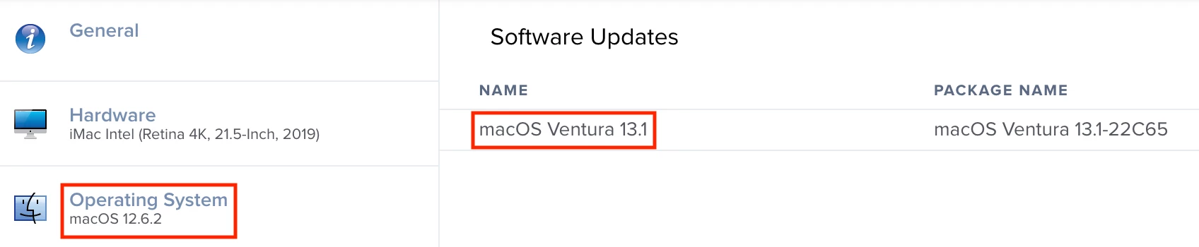

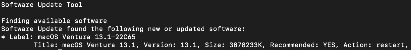

It appears that Apple's 12.6.2 update doesn't quite fix the issue which is why we're seeing the Ventura "update" run anyway.
AJPinto
  • Jan 13, 2023 6:11 PM UTC
+1, I've blocked InstallAssistant for years and this Ventura "update" comes through anyway when installed via Software Update in System Preferences.
Yes. When you block the InstallAssistant that is a binary that comes within the Install MacOS {version}.app. On Macs running 12.3+ Ventura comes down as a delta, there is no app to block any components of, there is no InstallAssistant.
AJPinto
  • Jan 13, 2023 6:12 PM UTC
There were hoops for the deferral to work. The devices needed to be fully supervised among a few other things. Check with your Apple SE to see what that list was, I cant remember what it was anymore. Though you can only block Ventura until the 22nd anyway, then its out of the 90day deferral window.
  • Employee
  • Jan 13, 2023 6:14 PM UTC
Correct, deferral is the only option here and that expiration is fast-approaching. I'm simply pointing out that 12.6.2 still shows 13.1 as a recommended update which is likely the core reason for these undesired upgrades.

  • Jan 24, 2023 8:28 PM UTC
In talking with Jamf just now we were told to upgrade to 12.6.3 to continue to restrict Ventura auto-updating. Here's the link from Apple describing what they updated: https://support.apple.com/en-us/HT212586.
  • Jan 25, 2023 12:03 AM UTC
Well it's moot now since the 90 day deferral period is over, but at least we know it was caused by Apple.
szultzie
  • Feb 15, 2023 3:52 PM UTC
So im fighting with Appel on this as well.  Its so random, i have a lab of 40 identical machines and some went to ventrua and some didnt all on 12.6.3.  Then i have other labs with different hradware and they are still on 12.6.3 and i run the same command on all of them each thursday night  softwareupdate -iaR
