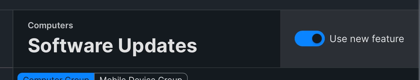

Try turning off the new Software Update Feature. Wait a few minutes or so. Then flip it back on.

If you're trying to cancel the DDM update, try the suggestion above. Then re-send the desired DDM Software Update you want.
Toggling off and on will attempt to cancel existing plans you mentioned.

I do not have permission to enable and disable services on the Jamf server.  Where you have a filed for "Use new feature" I have a big blank area.  My permissions on the Jamf server are limited.

I see. This is the quick fix your asking. Can you find someone with rights to assist? Once they toggle this, it may cancel the update you sent and then you can send a new one.
