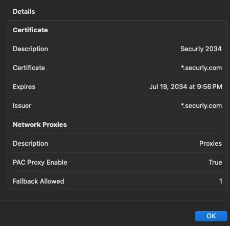

Our config profile is specific to us in the sense that it has our web filtering companies certificate + our SmartPAC URL in it. Therefore it's best if you download iMazing Profile Editor and build it to your organizations needs. https://imazing.com/profile-editor/download
The screenshot was just meant to show what is needed for captive portal pop-ups display as expected.

This is what our profile looks like when it's installed on a device. As far as I know captive portals are still working as expected. I know for sure the Starbucks captive portal wouldn't load until 'Fallback Allowed' (the key you mentioned I believe) was set to '1'.

@whiteb I added that to my config profile just now.. I will test it, thanks.
That did it. So for everyone else, i'll post my XML code for the config profile:
