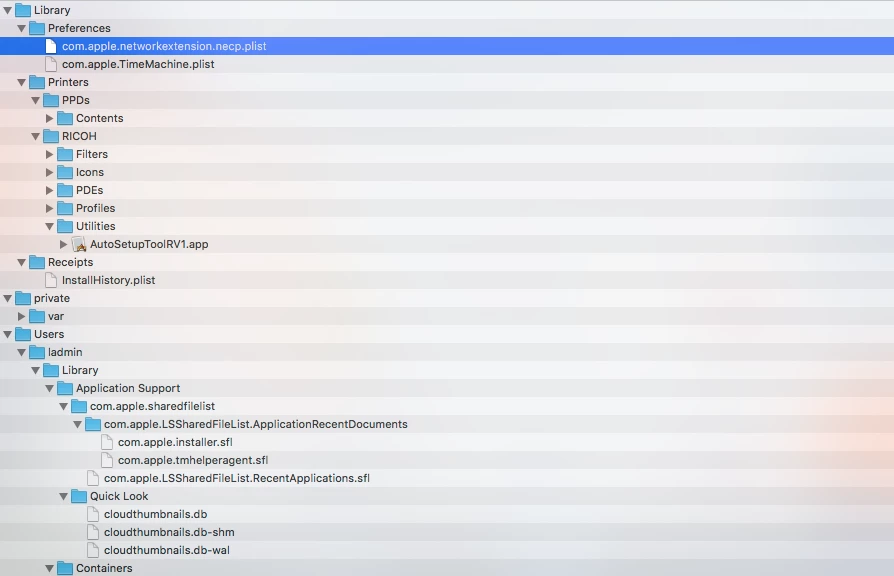

I have been having terrible trouble today with rolling out printer drivers for our Ricoh MP C2011 printer/copier using jamf. With all of our other printers I have been able to simply capture the installation using Composer, create a DMG and roll out that DMG in a policy.
With this particular printer however, I have been unable to get it to print successfully - It simply prints out pages and pages of random ASCII characters.
I just wondered if anyone could tell me what files are essential to printers

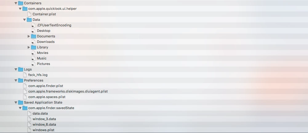

I had gotten rid of few files in the capture initially due to it picking up unwanted info like dock items and some keychain stuff - I'm thinking I might have gotten rid of something that is needed for the drivers to work successfully.
I have screenshotted the files that are picked up during the installation of the Ricoh drivers. Could anyone possibly tell me what is needed and what isn't?

@davidelliott why not just deploy the vendor package as is with Casper rather than trying to snapshot it with composer? Snapshotting printer drivers is not considered a best practice. I'm able to use the vendor supplied PKG file in nearly every case and haven't had any issues. We have some Ricoh devices and their packages install just fine from Casper. If you're installing the driver at imaging time you just need to make sure the "Install on boot drive after imaging" option is checked and it should install fine.

If you are going to capture the PPDs with Composer, just know that's all you generally need. I tend to use vendor packages as mentioned above, but I don't have RICOH units (We're HP, Xerox and Brother).
Here's a jamf KB on the subject
https://www.jamf.com/jamf-nation/articles/37/packaging-printer-drivers
I deploy our units using the lpadmin and would be happy to point you in that direction if you'd like as well.
