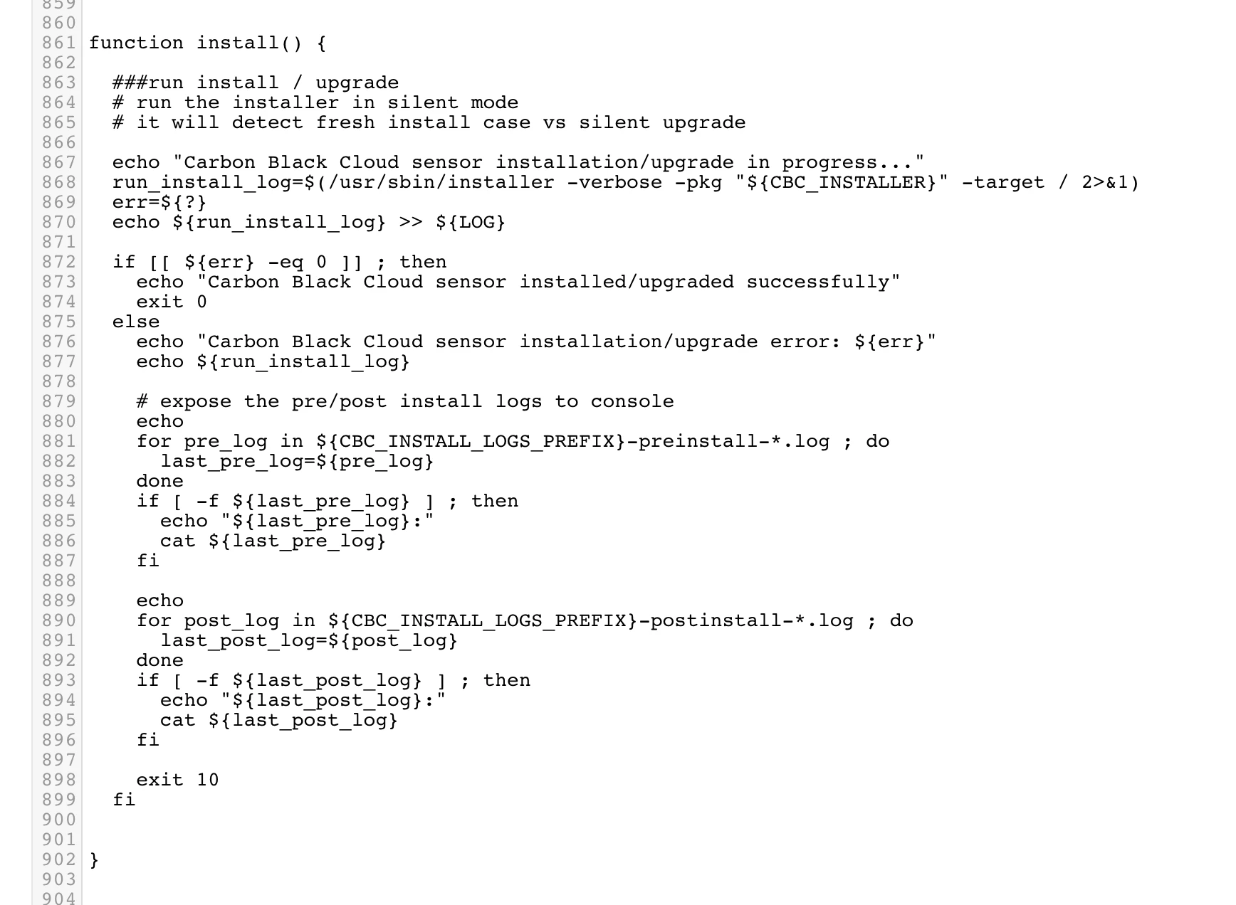

I'm getting an error on Catalina & Big Sur installs for CBC sensor 3.5.1.19.
Line 870: echo ${run_install_log} >> ${LOG}
What does ambiguous redirect mean?
Anyone else having any issues? I've started support with CBC also.

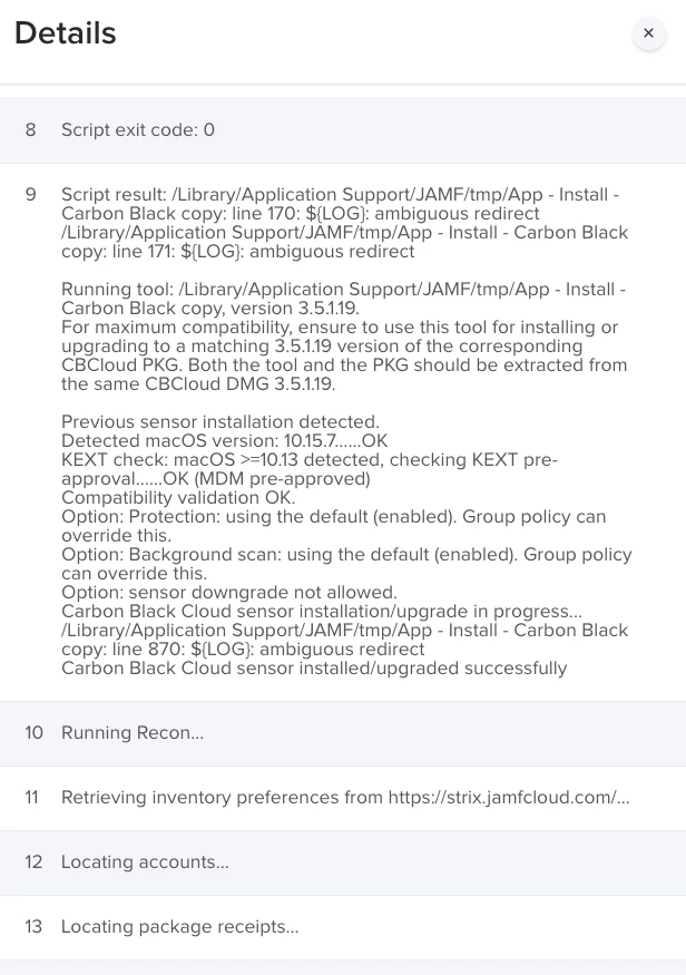

Same issue here calling the policy as part of a DEPNotify workflow -- it seems like the installation is fine despite the error. I noticed that calling the policy a second time manually via the terminal doesn't throw any errors. Same behavior on 10.15.7 and 11.1 - Intel. Let us know if if you've found a solution!

  • January 15, 2021
I saw this too. It's just an error with their logging output that doesn't affect the install.

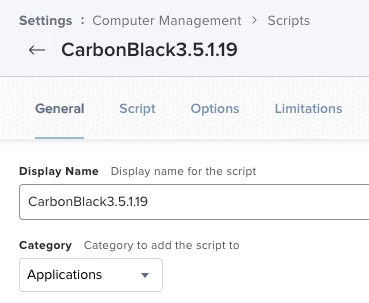

  • January 29, 2021
Got it. Finally. Arun was right all along. Lose the spaces in the 'Display Name' for the script. First time I have had it run without any errors.
  • February 2, 2021
@Phil.James thanks, I took out the spaces in the Display Name also and no issues / failures reported.

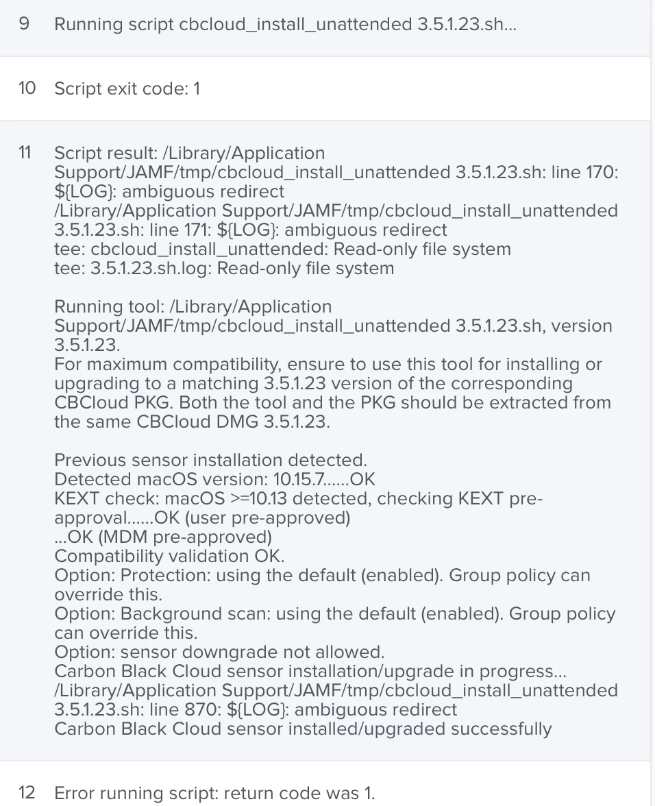

  • February 12, 2021
I'm trying update version 3.5.1.23. It installs on the Mac client, but Jamf shows errors. I tried the no space thing before on a previous version, but no difference.
What am I doing wrong?
I use Composer to package the "CBDefense Install.pkg" and install it at private/var/tmp. From there, the unattended script with that location and the company code runs next.
  • February 12, 2021

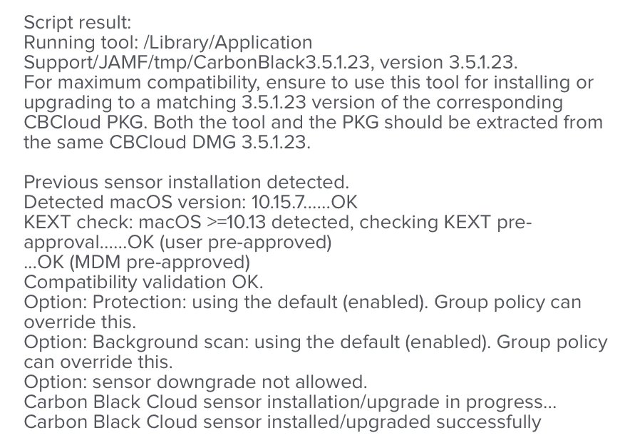

Can you change the script name to remove the space and try again, then show us the log? We know that the space does lead to errors, and I've run the .23 unattended in a similar way with no errors.
mvu
Forum|alt.badge.img+21
  • February 12, 2021
Thank you. That worked. Jamf shows green, completed. I double-checked my clean up a script to remove the CB installer from the private/var/tmp directory. That script had extra letters, so it messed things up. That was my bad.

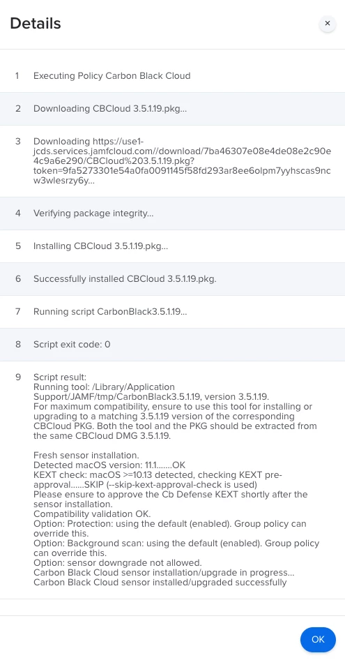

For a select few clients, the new CB Cloud just won't install even if Jamf has a green completed. These select few had issues with version 3.4.3.44, the "Confer.app" instead of VM Carbon BLack Cloud.
Here are the logs.
