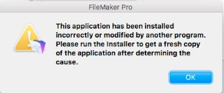

I have a .pkg of Filemaker Pro 15 which installs fine when imaging but ends up with this dialog when you try to run it:

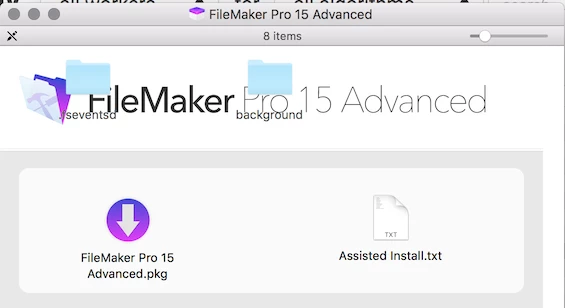

The problem it appears is because the .pkg installer needs to be able to see the 'Assisted Install.txt' file that comes in the original .dmg.
https://support.filemaker.com/s/answerview?language=en_US&anum=10842
Any idea how to make this visible to the installer?

Make a wrapper pkg that deploys both the FM PKG and the assisted install.txt to /tmp. Dump both to /tmp, call the actual FM installer with the postinstall script from your wrapper. When all action is done, have your postinstall clean up /tmp

If using Composer, drop the vendor installer pkg into a new folder in /tmp/ Call the folder whatever you want, but something short and descriptive is usually best.
Drop the Assisted Install.txt into that same folder.
Open Composer and drag that folder into the sidebar. It will create a new source with that folder and both files in it. Rename the source if you want to give it a more custom name. By default it will take the name of the folder you dragged in.
Turn down the disclosure triangle for the source in the sidebar, then right/control click on the Scripts item and choose Add shell script > postinstall
In the new script it creates, add something like this
/usr/sbin/installer -pkg "/tmp/<customfoldername>/FileMaker Pro 15 Advanced.pkg" -tgt /
rm -R "/tmp/<customfoldername>
Customize that with the correct folder name. This will install the FileMaker Pro 15 Advanced.pkg package with the Assisted Install.txt in the same location, so it should hopefully see it and use it.
Now build the package as a .pkg file and test.
