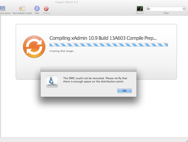

Casper Admin 9.2 gives an error when I tried to compile a configuration on OS X 10.9.
it says "The DMG could not be mounted. Please verify there is enough space on the distribution point."
Our Windows SMB distribution points have enough space on them.
I can compile configurations on OS X 10.8.x systems.
external image link

JAMF identified it as a defect: D-005612

This behavior is related to D-005612; it's something we see specifically with Windows SMB share points and is an issue between how Mavericks' SMB2 communicates with Windows SMB.
In some situations, when Mavericks is connecting to an SMB2 file share on a Windows machine, there can be problems with the permissions on the client side. This particular issue is almost universal on Windows Server 2008R2 SMB shares.
A common fix recommended online is to connect using CIFS:// instead of smb; this would force it to use the slower SMB1 protocol, but also would take care of the error. Currently, it looks as though this is the route our Development team is looking at to get the issue taken care of.
This thread on Apple's discussion forums goes into it a bit more: https://discussions.apple.com/thread/5467191
http://cammodude.blogspot.com/ has posted a workaround to force use of the SMB1 protocol, but it's a use at your own risk workaround, as we have not tested it thoroughly here. If you do try out that workaround and it's successful, please let us know!

It's one we're still working on, as this is a third party issue; specifically, it's an issue with Mavericks' SMB2 not passing credentials in a way that the version of SMB Windows 2008R2 uses is willing to accept.
At the moment, development is still looking into ways to get around it, but as the issue appears to be at the OS level on both sides, unless something changes on Apple's side or Microsoft's side, it could take a bit more digging to find out how we can get it working reliably without messing anything else up or having to force it to use the slower SMB1. The way it looks right now, we may end up having to force it to use the older protocol unless Microsoft decides to release an update for 2008R2 (which isn't all that likely) to address it.
The error message Casper Admin gives isn't exactly the best in terms of wording, but it really has nothing to do with actually being out of disk space in this particular situation, it has to do with the Windows SMB share rejecting the way the credentials are passed down from Mavericks using SMB2, which is why the DMG can't be mounted.

https://discussions.apple.com/thread/5483728 One poster there mentioned that doing the following helped in their environment: - Set Lan Manager Authentication Level to "Send NTLMv2 response only" - Connect from the client without specifying a domain, just enter the shortname and password. There are some of the longer discussions on the matter on Apple’s discussion forums, most of them having been started last fall and a good chunk of them still being active until very recently; I haven’t had time to go through all of the pages, but mixed in with the ‘me too!’ replies, there are things others have tried to try and get it working in the thread below. It looks like the most common workarounds out there are the ones that have already come up here, but there were some Windows side workarounds that may be worth looking into. https://discussions.apple.com/thread/5500165 <— this one has a few different settings to change on the Windows side of things, usually through PowerShell. Sweetcider went into a little more detail on the changes made in PowerShell. A couple people there said enabling “Force NetBios over TCP/IP” on the Windows side helped the speeds in their environments. On page 6 of that thread, the user Jorge Secco Caetano posted a couple of registry keys to try changing as well; a couple users reported having success with that, so it may be worth looking into. User ncalliari expanded on that with the DWORD values that were necessary.

I did use the SMB1 modification today and that got around the error, but after 8 hours of compiling I decided to revert back to autoDMG to compile my OS installer.

I can confirm that Workaround Option 2 worked for me.
