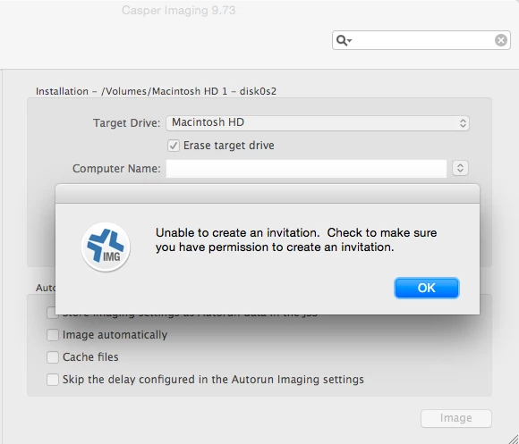

As we got JSS updated to 9.73, Casper Imaging stopped working. After choosing the Configuration and providing my JSS account credentials I get the error message:
"Unable to create the invitation. Check to make sure you have permission to create an invitation"
I have administrator-privilege account with everything checked on JSS User Accounts & Groups side.
Please help. Thanks!

Garrett Schmidt brings the idea: "Close down Casper Imaging completely and then re-open it while holding down the Option key. This will let us refresh the credentials for Imaging"
After that Casper Imaging is working in Target Mode as well.
Thanks, Garrett! Thanks, Darrin, Brian!
