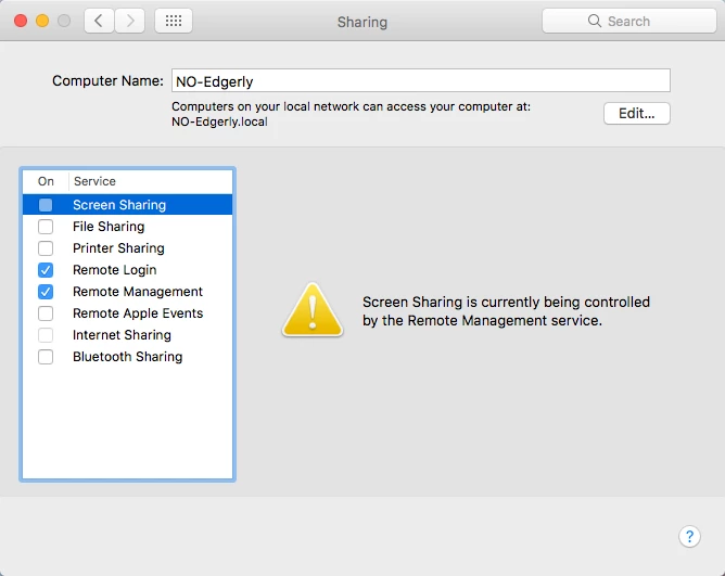

As part of our SOE, we have both Remote Login (ssh) & Remote Management (screen sharing) enabled.
To share the screen of another computer, ssh must be enabled on the target computer and if the target computer has OS X 10.10 or later, Screen Sharing must also be enabled on the computer
- System Preferences > Sharing > Remote Login
- System Preferences > Sharing > Remote Management
Hope that helps!

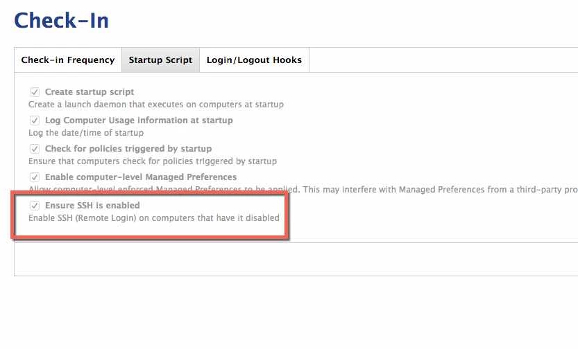

*Note: we do have a local admin account for each school for the onsite tech. We also have the Startup script ensure SSH is enabled to push on the backend

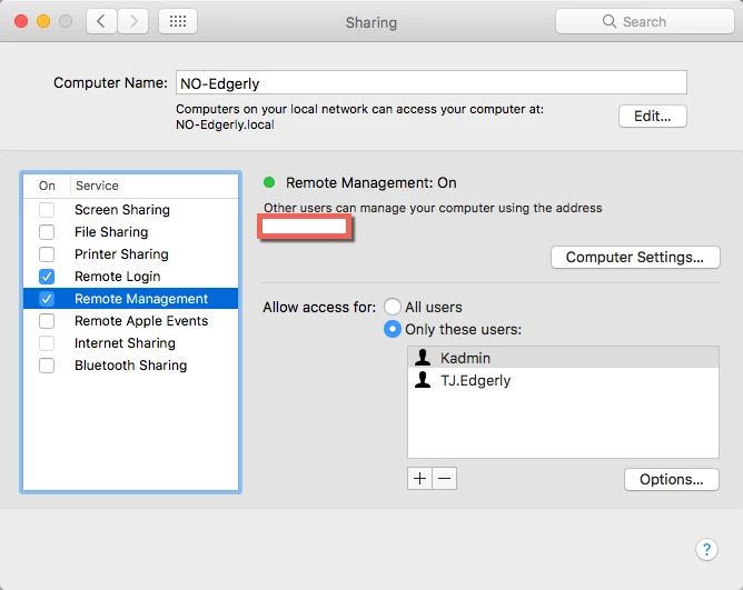

@NaomiT If i'm understanding you correctly, you are trying to add a specific local admin to the Remote Management List (Not sure if you are referring to "Remote Login" or "Remote Management" under the System preferences>>>Sharing section.
If you want to add under the Remote management section with a local admin user, the script i posted above allows you to set a specific account.
/System/Library/CoreServices/RemoteManagement/ARDAgent.app/Contents/Resources/kickstart -activate -configure -access -on -privs -all -users <ADMIN ACCOUNT>
Ex. (To add kadmin account)
/System/Library/CoreServices/RemoteManagement/ARDAgent.app/Contents/Resources/kickstart -activate -configure -access -on -privs -all -users kadmin

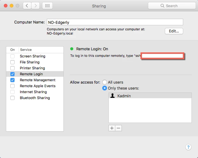

If you are wanting to add a user under the Remote Login Service you have a few options:
[https://www.jamf.com/jamf-nation/discussions/7153/remote-login-all-users
](link URL)
sudo systemsetup -setremotelogin on
running from a casper remote session, will turn the remote login back on. Since my account is local admin account, it is re-enabled if is was disabled.

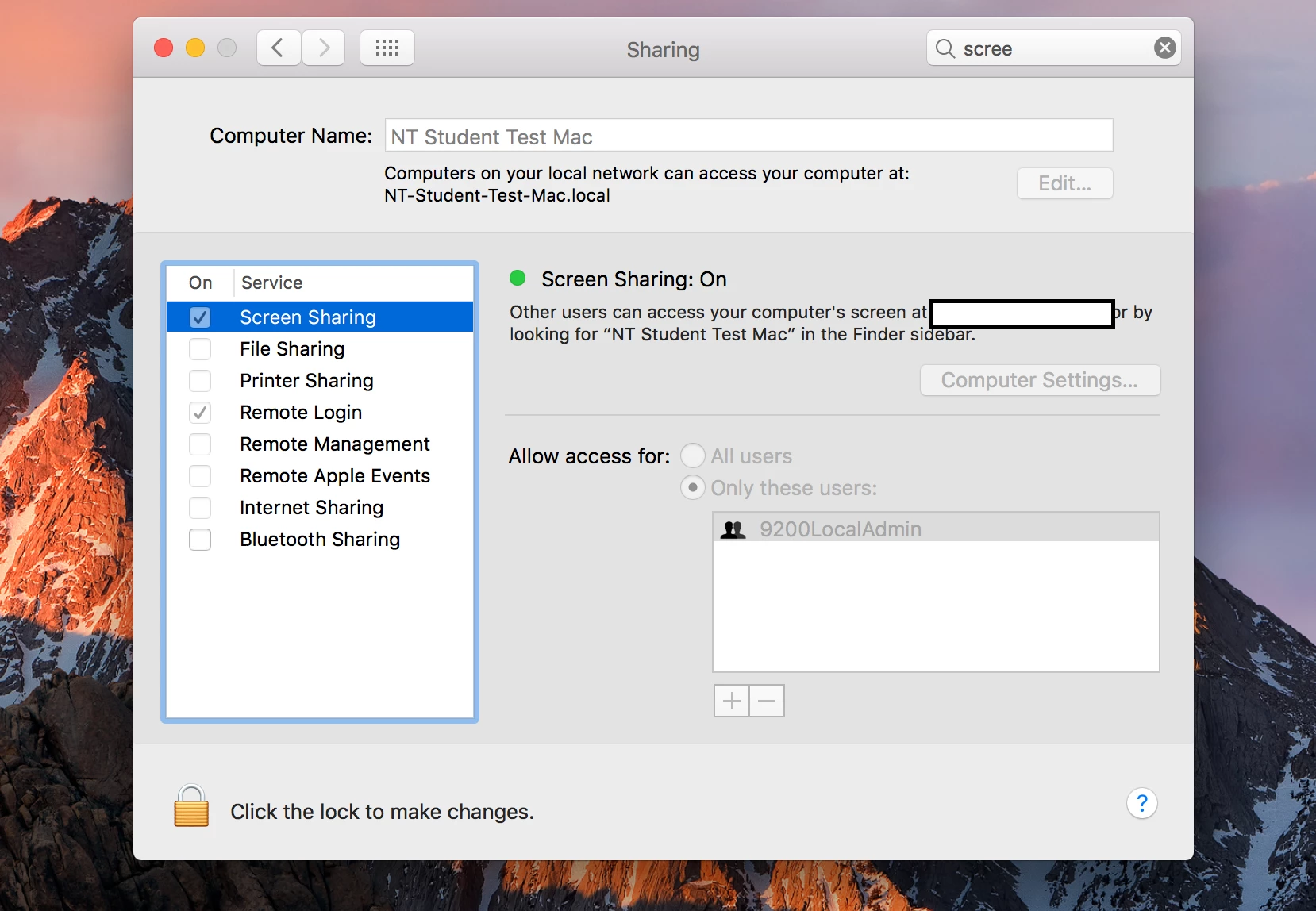

@TJ.Edgerly Thank you! I have attached a screenshot.
I would like to automate enabling screen sharing and adding the group I have listed in the screen shot.
@NaomiT I see, In the past is have just leveraged the Remote Login and Remote Management section (VNC is still enabled with those two options).
Since I enable remote Management that portions takes over the Screen sharing portion.
@TJ.Edgerly I was able to use the script you posted above and now I have the "Screen Sharing is currently being controlled by the Remote Management service" message like you posted above as well. The problem I have is that the user group is not listed under Remote login (Kadmin) in your example. I used this script below:
/System/Library/CoreServices/RemoteManagement/ARDAgent.app/Contents/Resources/kickstart -activate -configure -access -on -users 9200LocalAdmin -privs -all -restart -agent -menu
I'm not familiar with scripting and not sure where I made the mistake.
