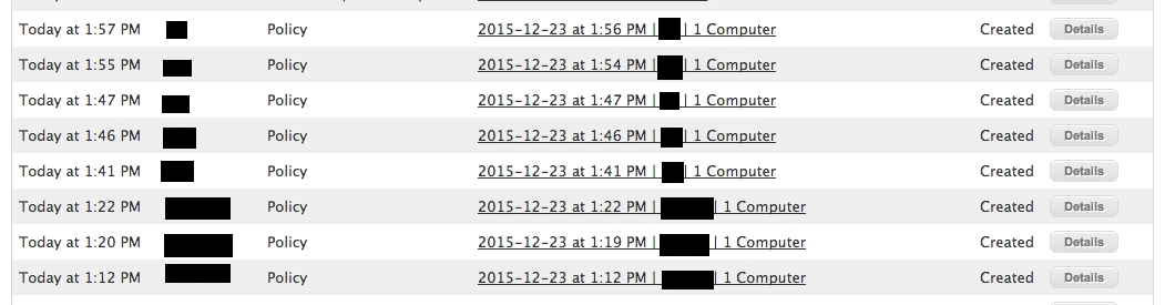

Nearly keeled over when I perused the JAMF change management logs and noticed a bunch of policies created using an unfamiliar naming convention (using pipes). My first thought was "who is doing this?!"
After some digging, we determined Casper Remote creates a hidden policy each time someone pushes a package.(*) This might sound trivial, but I'm going to leave this here in case anyone searches for invisible policies.

Don, nothing new. Its worked like this forever. At its heart, since the Casper Suite is, and always has been, a client -> server check in process, and not a server -> client push process, it needs to create these "on the fly" policies, get them scoped to the Mac or Macs that were selected by the admin in Casper remote, then SSH into each Mac and direct it to "check-in" to the JSS run the policy. That's just how it works.
If there's anything that should come from this, its perhaps a feature request to not have them show up in the 'regular' policy logs, but in their own separate tab so they don't end up cluttering the policy log view. We rarely ever use CR here, so they aren't a concern for us, but I can see how it could be confusing to see these policy logs in the regular policy log location, especially if you do a lot of Casper Remote work.
