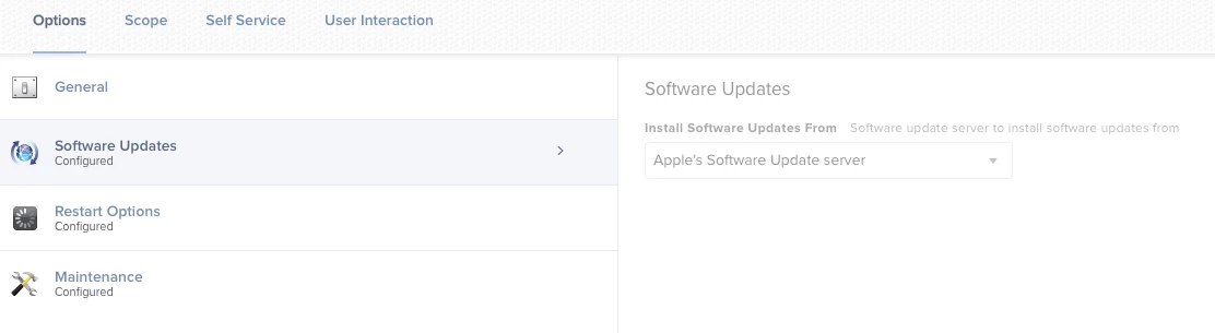

Anyone experiencing Catalina Macs booting to the recovery partition after installing a macOS update?
FYI we are using the Jamf built-in Software update policy.

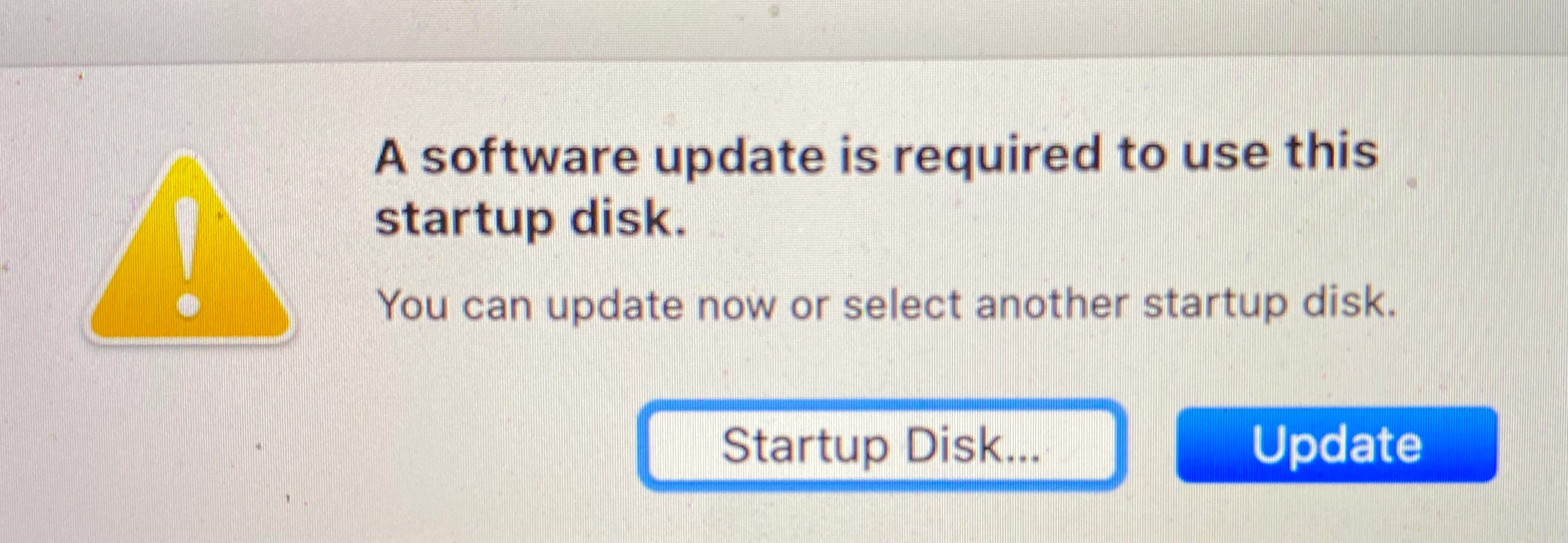

I just installed the Catalina update on my machine. Since the update requires a full shutdown rather than a reboot, it returns an error similar to these screens. A quick power off and power back on resolves it.

We had the same problem with the 2020-003 security update. I think the issue is with T2 equipped Macs, which as you note, need to be shut down instead of rebooted. The Software Update policy in Jamf doesn't properly shut down T2 Macs and they reboot into the state shown above.

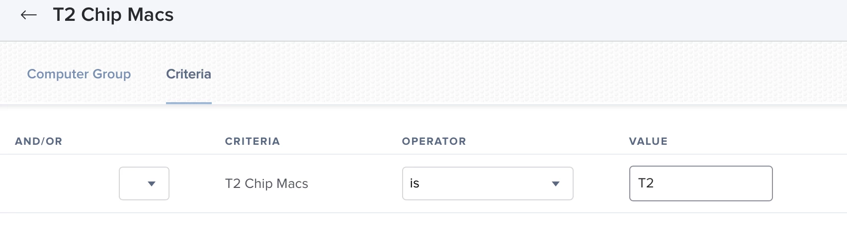

is there an easy way to make a group for T2 devices? scope by 2018 model and newer? i do not see anything related to it in the inventory
  • July 20, 2020
@hdsreid Use an EA

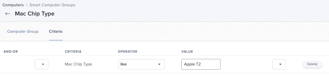

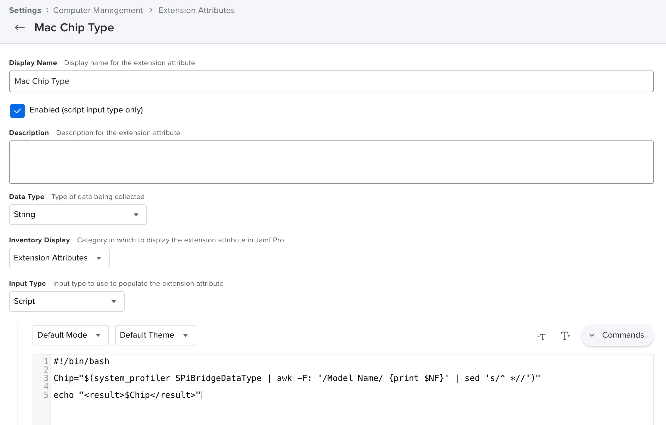

This might be simpler...
Create a Computer EA with this script... (See Images as well)
Than check your inventory... (Remember to update inventory)
At that point, make a Smart Group or Advanced Search
!/bin/bash
Chip="$(system_profiler SPiBridgeDataType | awk -F: '/Model Name/ {print $NF}' | sed 's/^ *//')"
echo "<result>$Chip</result>"
  • July 20, 2020
@HCSTech I just made the EA in your latest post and set up my groups. So far so good, thanks for the detailed example!

@HCSTech Thanks! What should my search criteria be?
  • July 20, 2020
Similar. I do Like T2...
Keep in mind that this will not be complete until Inventory

The issue here is when bridgeOS is being updated and the update is calling for a shutdown instead of a restart. The Jamf policy softwareupdate binary does not support the shutdown flag, which causes the update to not apply. Apparently this fix was implemented in Jamf Pro 10.23.0 but I haven't yet tested it: https://www.jamf.com/jamf-nation/feature-requests/7285/add-softwareupdate-restart-support
