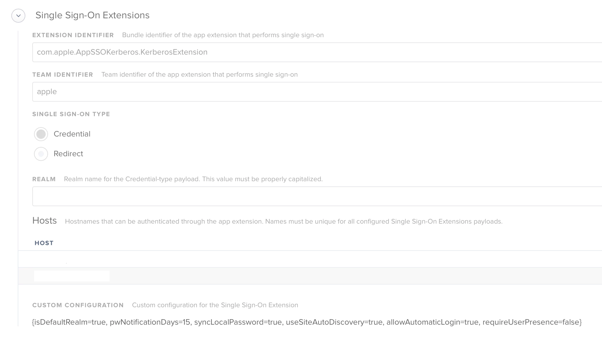

@ammonsc , I have tried changing that and rebooted and still nothing. I wasn't sure if I had it setup incorrectly because it says that capitalization matters, which I think I have it right, but honestly it may be wrong.
@ammonsc Yup. Heres a screenshot of our config.

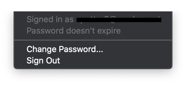

Just checking if others have this working properly? I am using the posted sample PLIST and changing the domain and realm. I can log in to an AD account fine, but (1) the extension is showing my password never expires, which is not true and (2) it is not sync my password with my local account. If I log out, I have to use my original local password and not my AD password to log back in.

What is the value for host? Is that suppose an alias for the realm

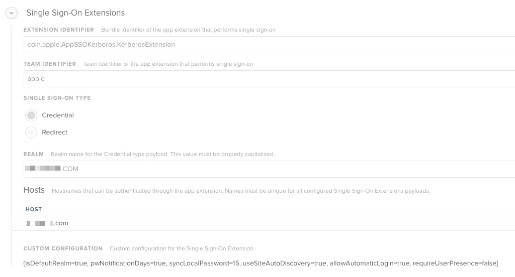

Have tried SSO see screenshot, still can't get it to auto load and fill in their AD credentials automatically. Have tried adding the etc/krb5.conf and no joy. Wondered what other people have done on here to get it to work.
@VladCabrera Hosts are the hosts that you want the extension to perform authentication for.
i.e. kerberos-site.mycompany.com
Most likely you want your hosts to be ".company.com", notice the period. That way it covers all addresses under company.com.

The only issue I'm seeing with the SSO is the fact that it states my password doesn't expire. Is anyone else seeing this behavior?
When I would first deploy it it would report that my password never expires. Once I logged out and back in it would report accuratly.
I'm consistently getting "Password doesn't expire" plus when I navigate to internal sites that use SSO Safari just hangs on a blank screen. If I take out the leading "." in hosts, the menubar icon just says "Updating Updating" and Safari forwards to my company's SSO host (I'm assuming this is basically just what would happen without the plugin). Enterprise Connect with as many matching flags as are supported works great. I wondering if maybe I need a redirect style profile that points to some URL like https://sso.mycompany.com/somethingsomething.
