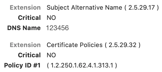

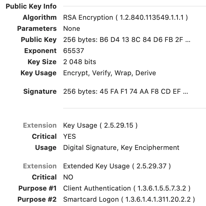

We use successfully Kerberos Extension with passwords but would like to switch to user certificates using Yubikey.
In Kerberos Extension chooser certificates doesn't list.
Note: certificates come from our PKI (same as smartcards) and have the following attributes.

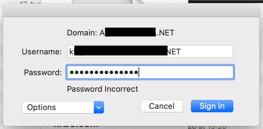

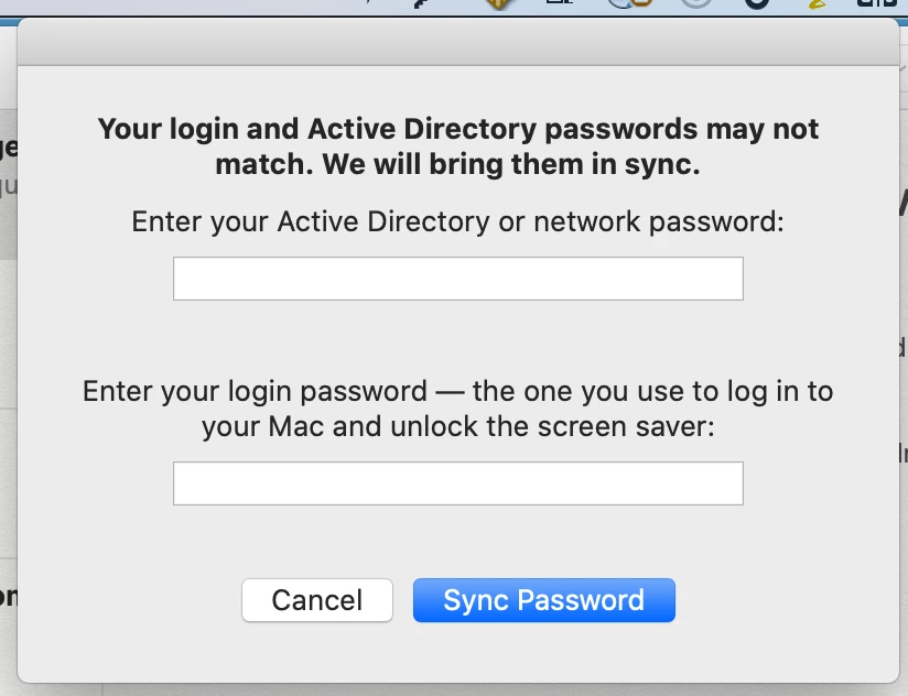

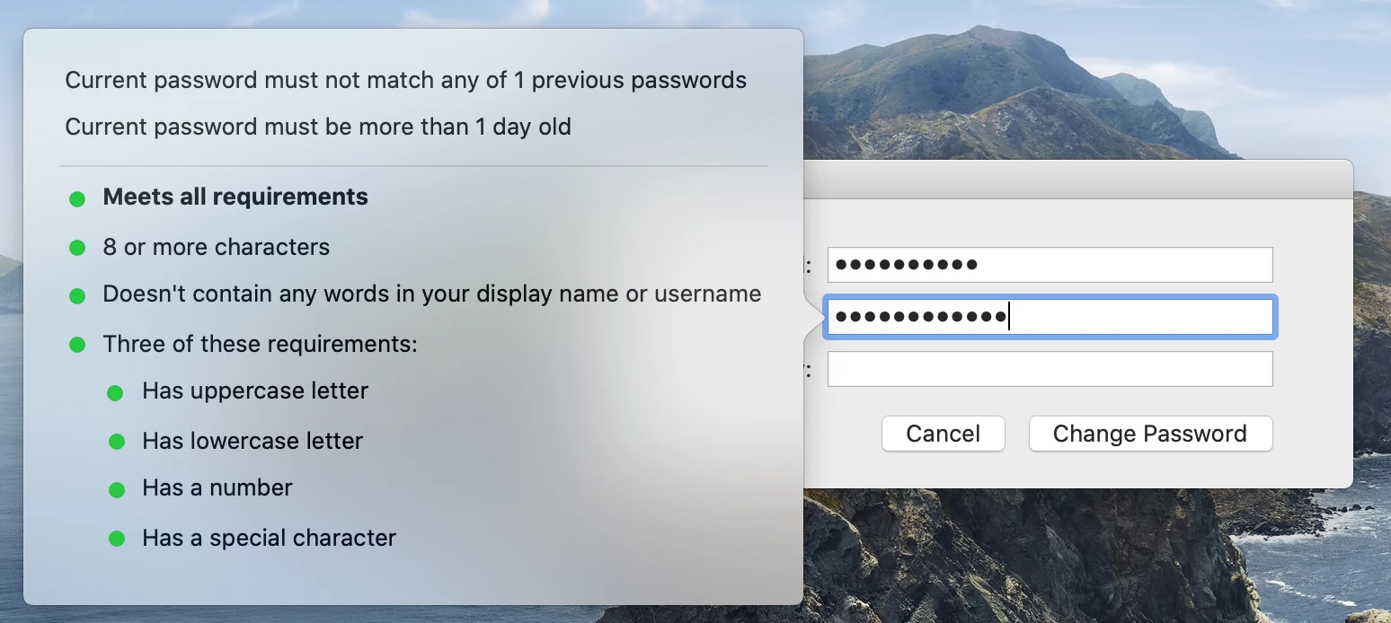

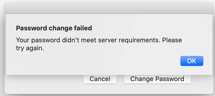

Hi all, Great thread have this sort of working accept on password change I get the following error box even though I know I'meeting the password criteria which is min 8 characters, at least one upper case, a number and a symbol so a password like JamfPassword44! would be valid.
As I've been told the password failed if I log in with the previous password that tells me its incorrect
Now if I use the new password (the one that failed in the first screenshot) it works and I get the sync box:
So why am I getting the password failed when it works?

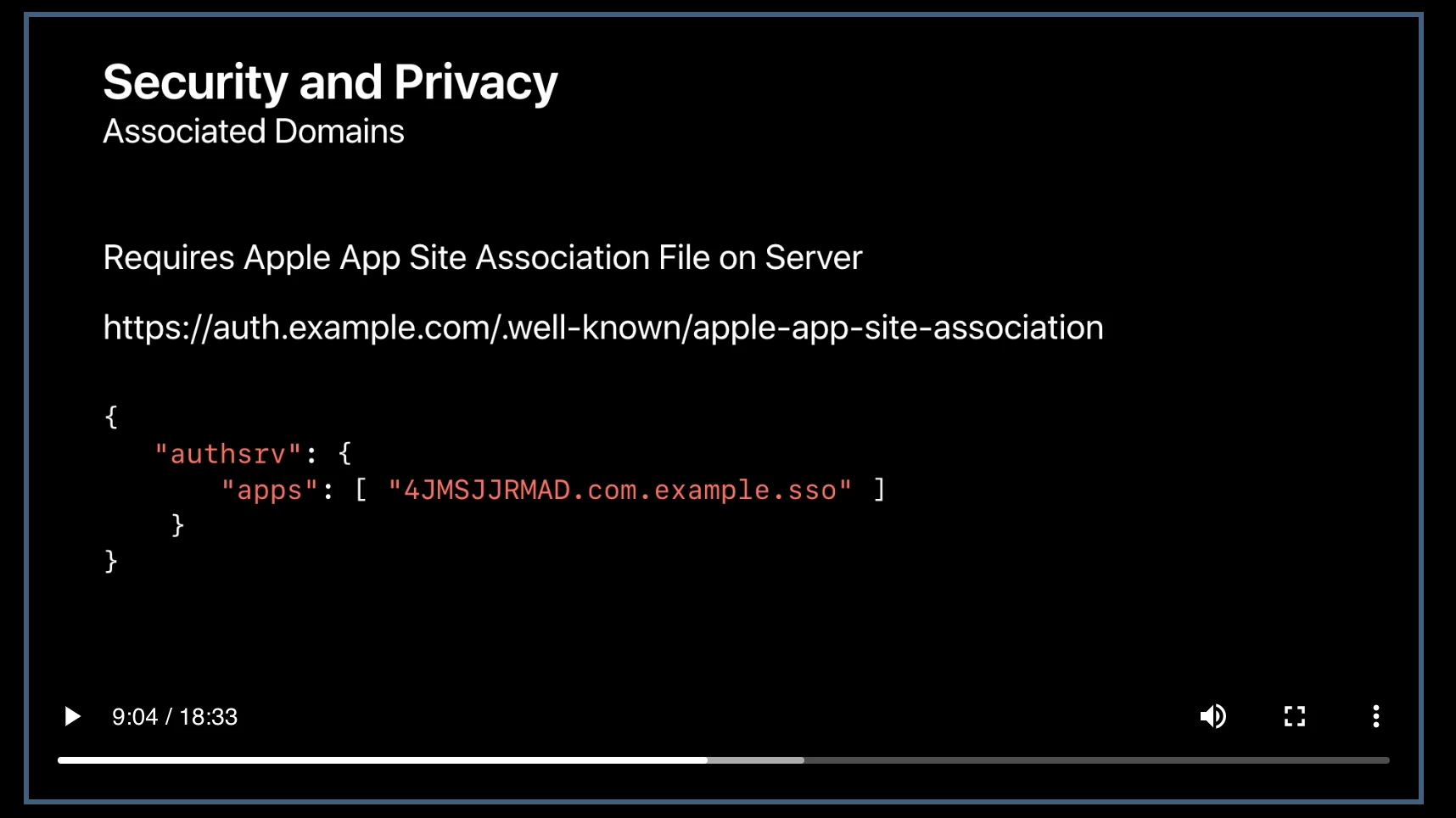

Where I will add the apple-app-site-association file for SSO extension?
In wwdc19 tech-talk videos they told to add a association file on server. My Question is that where I have to add this file "Identity provider" or "somewhere else"?
{ "authsrv": { "apps": [TeamId.com.example.sso] } }

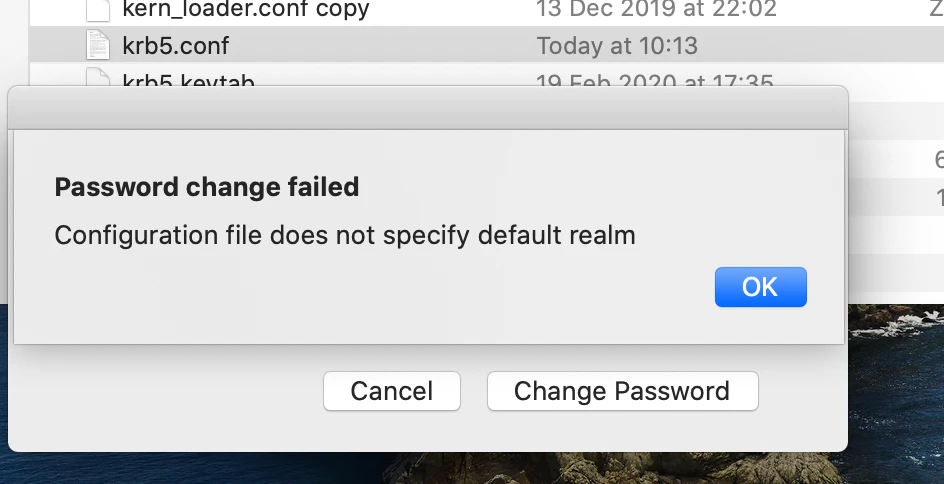

@jr139, did you roll it out to all Mac devices in your environment. How did you manage to deploy the krb5.conf file?
added the krb5.conf but still get the error
