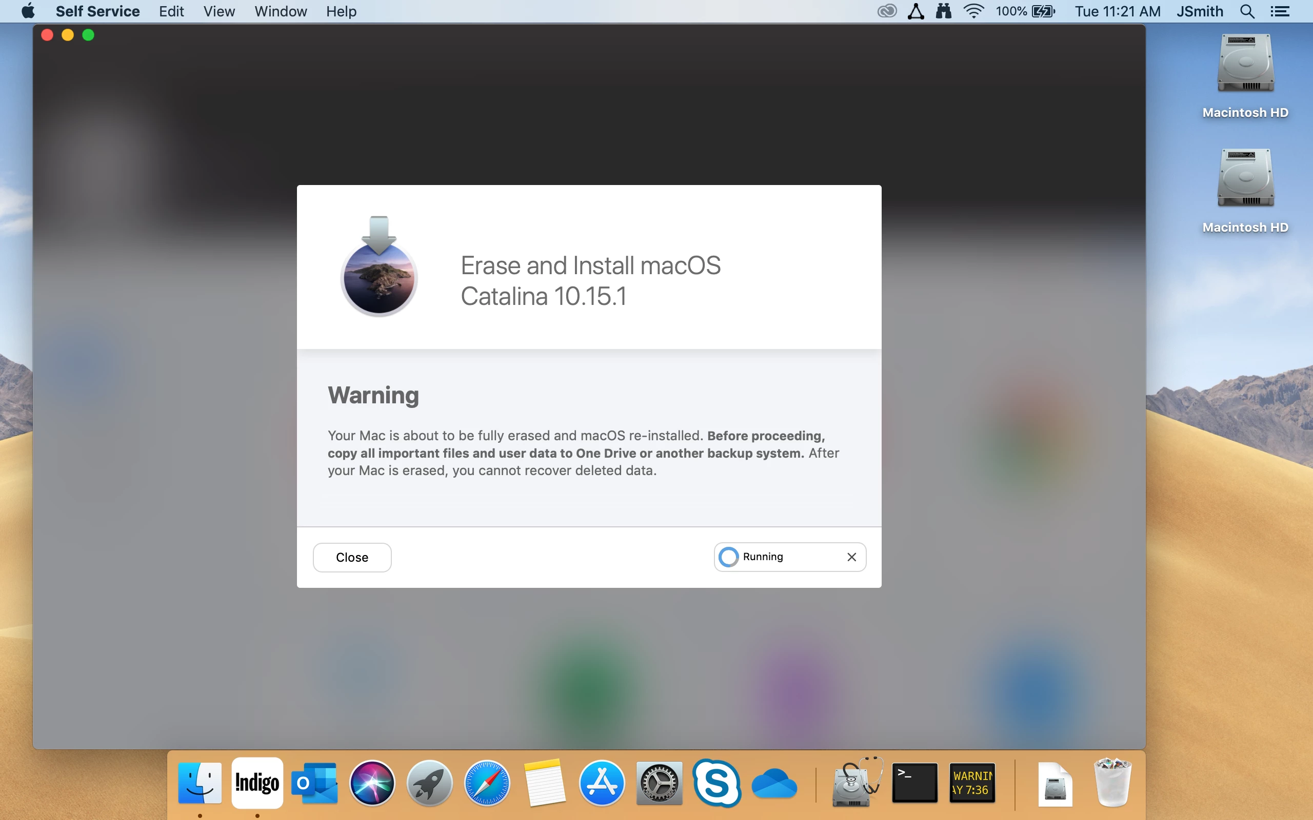

I’ve been banging my head against the wall on this one. I’m also using a Files and Processes Self Service policy with the following command: /Applications/Install macOS Catalina.app/Contents/Resources/startosinstall --agreetolicense --nointeraction &
This has led to inconsistent results. Some of my test machines are installing flawlessly. Others just sit and never seem to do anything while still others will have an error to the effect that Self Service can’t save and quit, though if I click through the error dialogs it does quit, restart, and complete the install.

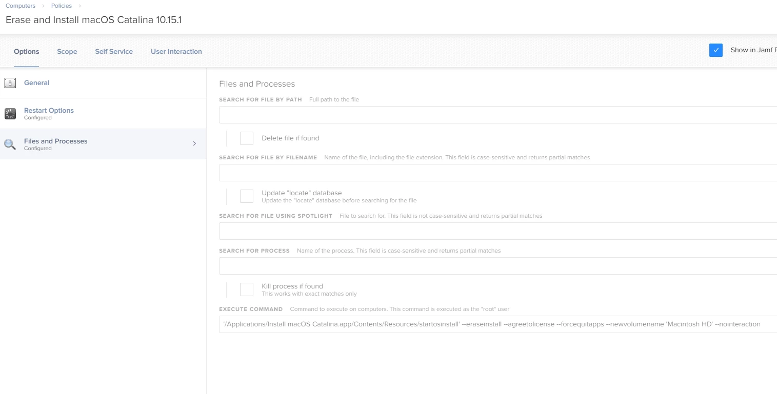

I am in the same boat where I have deployed the Catalina installer package to targeted machines and set up a policy to execute the following command.
'/Applications/Install macOS Catalina.app/Contents/Resources/startosinstall' --eraseinstall --agreetolicense --forcequitapps --newvolumename 'Macintosh HD' --nointeraction &
In theory, this should quite all open apps, restart the computer, wipe the drive and install macOS Catalina.
All it does is create a new partition and dump the installer files in there. That's it !
What am I doing wrong here?

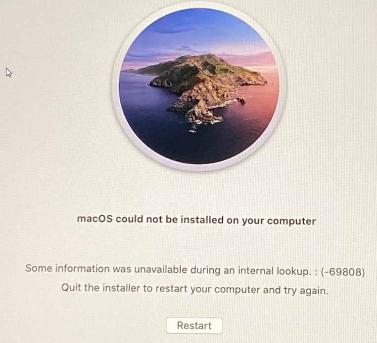

  • November 19, 2019
im having the same issue, i continue to get this error not matter what i do.

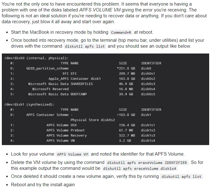

Just found these steps and it WORKED, the only thing different i did was the command to erase the volume
diskutil apfs eraseVolume disk1s4 -name Vm
