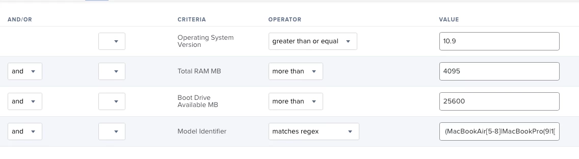

Its in this section on that page "Identifying Macs eligible to erase and install". It explains how to build the report based upon certain criteria to create a smart group. Once the group is created you can export the report.

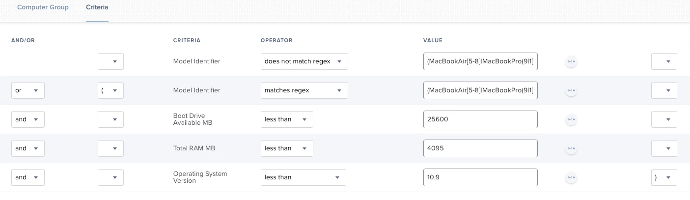

Also how do I pull the report from Jamf for the Non eligibility of Catalina upgrade.
If you read that blog post, the section @Jason33 pointed out is pretty clear. If you create a Smart Group using the criteria that is written out in the gray box and add the regex that is in the next gray box, you will have a Smart Group showing you all systems that are compatible with Catalina.
You will need a second Smart Group to show machines that are not eligible. Just reverse your criteria a bit:
