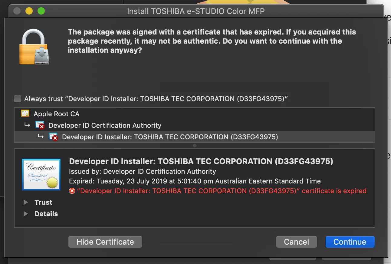

Before attempting to work around this certificate issue, I would head over to Toshiba to see if they have an updated package you can download for these drivers. Package installers from known commercial developers have signed certificates in them that are trusted and the Apple installer can check on. If the embedded cert has expired or been revoked for any reason, it will see this and not allow the installation to take place unless you choose to override it. This is a security precaution, to prevent you from installing a potentially compromised or damaged installer package on your Mac.

I have the exact same issue today - yet to try responses but after heading to Toshiba's website and getting the latest drivers, it looks like their Developer certificate expired yesterday...🤦🏼‍♂️
Let me guess this happened yesterday?
As I was imaging a room after SSD upgrades yesterday and had the same issue with out ToshibiaMFD driver .pkg package. And it was running fine on Monday as I had done another room.
I have to do the following from this thread:
https://www.jamf.com/jamf-nation/discussions/4113/fixing-packages-with-expired-signatures-heads-up
These commands expands and then re flattens the pkg while removing the cert all together.
