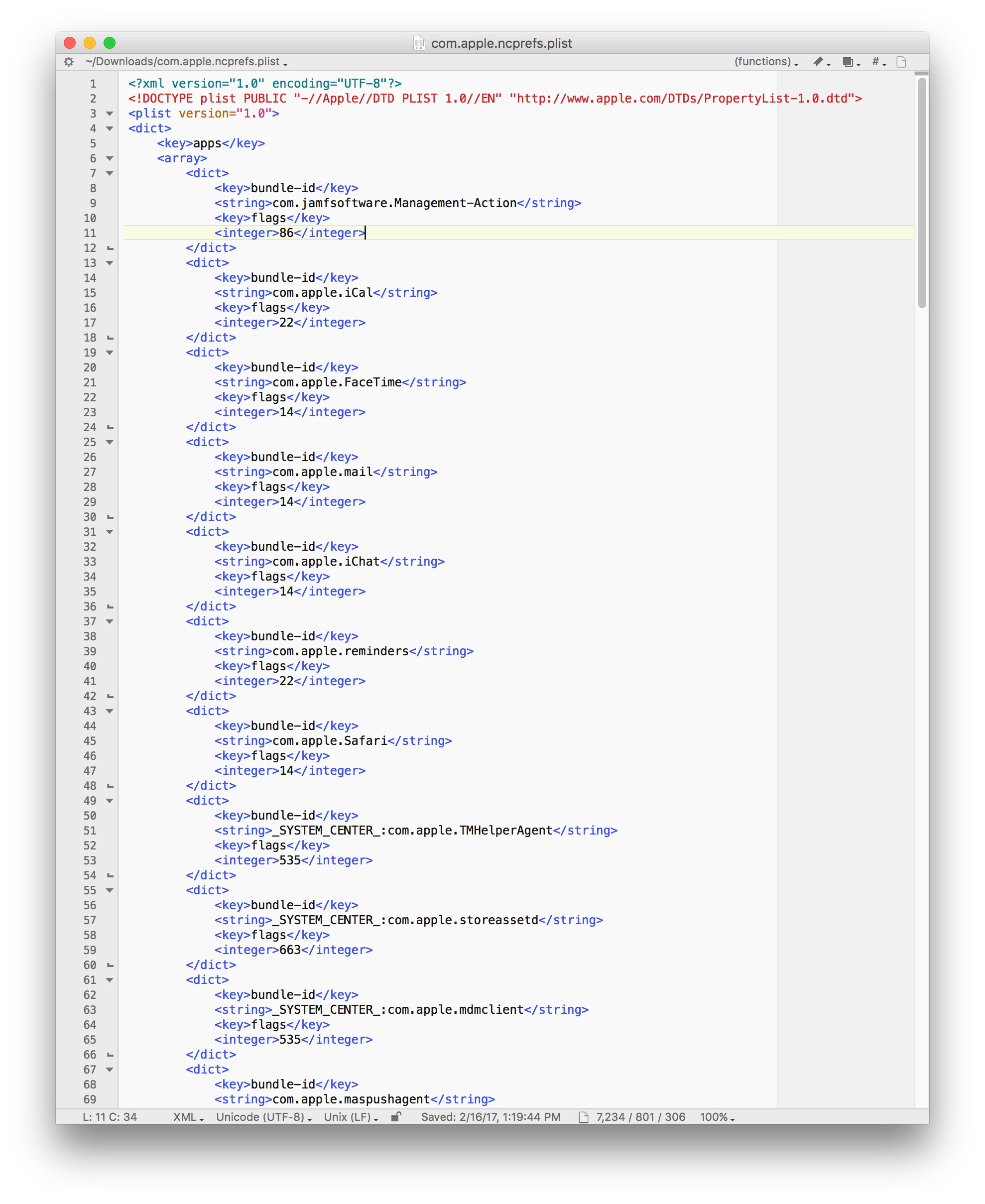

@matt4836 I took a look at your python script as well as some other similar open source projects and found that none of them seem to work any longer (in macOS v10.12.3).
In your research for this script, did you happen to come across a key to decoding the "flags" values found in ~/Library/Preferences/com.apple.ncprefs.plist?
There are some common recurring values such as 14, 22, 86, 535, and 663, with the higher numbers seemingly reserved for Apple applications and system services.
I have had some success with delivering settings via custom payloads in configuration profiles, but I'd like to fully understand the potential values of the flags key.

  • June 14, 2017
@milesleacy It was a bit-shifting. If I recall 14 was the default value. 14 as binary, 000001110. By changing values from 0 to 1 turns on different preferences. Look at my script to see the values. 1 << 5 would turn on the fifth bit. Hope that helps.

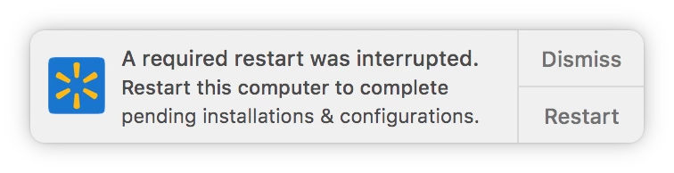

  • August 30, 2017
@ClassicII If you're referring to the notification icon below, that's my own compiled instance of yo.app, with a company icon swapped into the Xcode project before compiling.
https://github.com/sheagcraig/yo

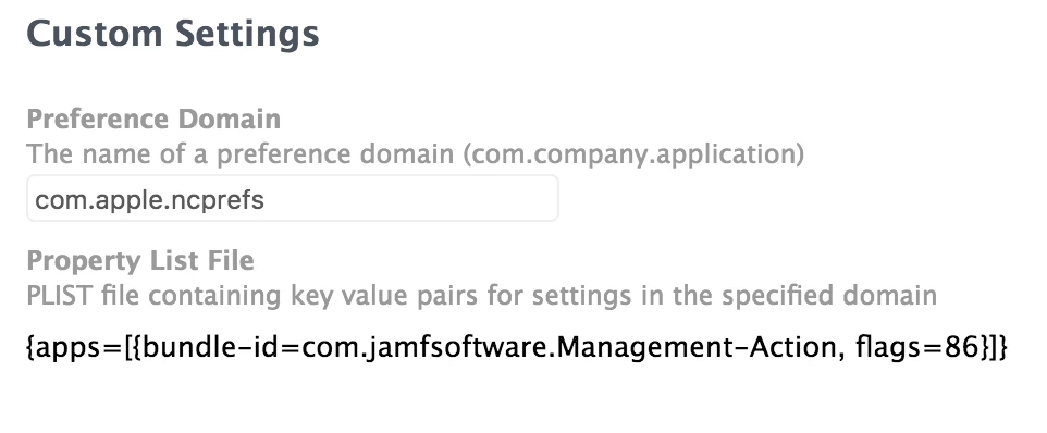

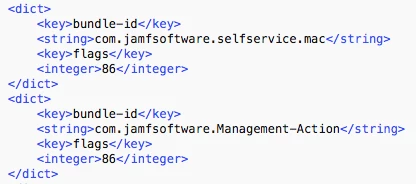

  • January 22, 2018
@UID501
You'd have to customize the profile further than capturing a local com.apple.ncprefs.plist file and uploading it to a custom payload in Jamf Pro.
To manage only the setting(s) you're interested in, you would have to make a copy of the file and delete all superfluous items before uploading. In the case of configuring the Jamf Management Action application, that source file for the custom payload would look like this...
<plist version="1.0">
<dict>
    <key>bundle-id</key>
    <string>com.jamfsoftware.Management-Action</string>
    <key>flags</key>
    <integer>86</integer>
</dict>
</plist>
Note: If you wanted to set this for both Management Action.app and Self Service.app, I would recommend two separate profiles. Modulatity is key. You, your management, or your users may come up with reasons to change one setting and not the other, in which case, it is cleaner, easier, and less disruptive if the settings are in separate profiles.

  • November 7, 2018
You have to make sure to include the extra dict & apps array. Also, you need to kill the notification center to see it right away.
killall sighup usernoted NotificationCenter
<dict>
   <key>apps</key>
   <array>
      <dict>
         <key>flags</key>
      </dict>
   </array>
</dict>
</plist>
