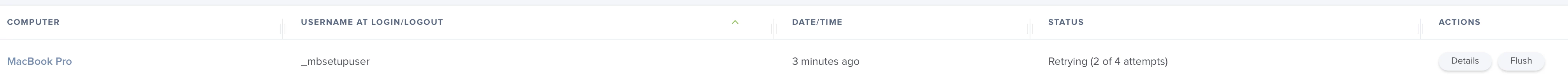

  • February 10, 2022
Thank you for this solution but it works not always for some reason. Every second time it changes name to setup.user and setup-user even i created "Jamf Test" user as Full Name on PreStage enrollment
I'm guessing here but since this appears to be happening at enrollment and sometimes you get the naming you want, I think this is a timing issue.  I think the user you are expecting hasn't been created yet or the system hasn't logged in as it yet or something else.
For my DEP machines, which aren't domain joined, I rename them at enrollment complete by their serial number, that way we can actually find them easily in the JSS.  Then later, I have a script available in Self Service and at login to prompt to rename the machine.  Our techs still "setup" machines for our clients as we haven't moved completely to the out of box experience.
If it is a timing thing, perhaps naming your rename policy to zzz.rename-mac will help you out since zzz will be the last thing to run after enrollment.
Notice below in your screenshot that the "user at login" is mbsetupuser.  Might be a clue as to what's going on, might not be! ;)

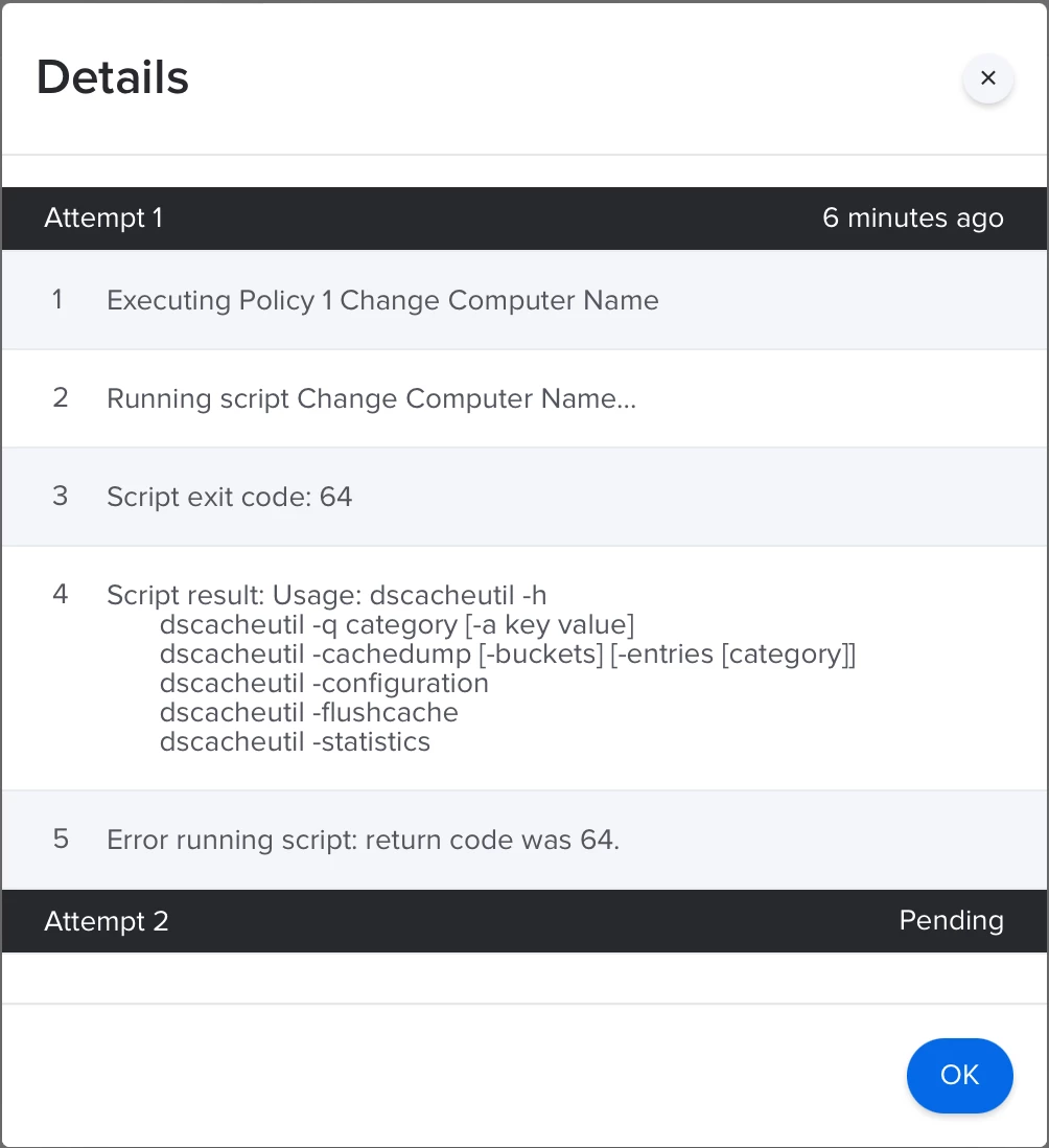

  • February 10, 2022
In the script you posted earlier, there's a typo. It should be
/usr/bin/dscacheutil -flushcache
Your script shows it as
  • February 10, 2022
Thanks, copy/paste issue.  Fixed above.
  • February 10, 2022
The script you posted also showed the incorrect syntax. Did you verify that it's -flushcache in your script? I've just used
in my script.
  • February 12, 2022
@ubcoit I think you are right, script runs straight after enrollment completed, but account is not created yet. I changed policy to run after log in and it works :) Than you very much!
  • June 25, 2022
When I try running this script I get the following error below.
Is the script still working for you? @Kirill11
Executing Policy return the username
Running script change computer host and localhost name to specific values after enrollment....
Script exit code: 64
Script result: Usage: dscacheutil -h
dscacheutil -q category [-a key value] dscacheutil -cachedump [-buckets] [-entries [category]] dscacheutil -configuration dscacheutil -flushcache dscacheutil -statistics
Error running script: return code was 64.
