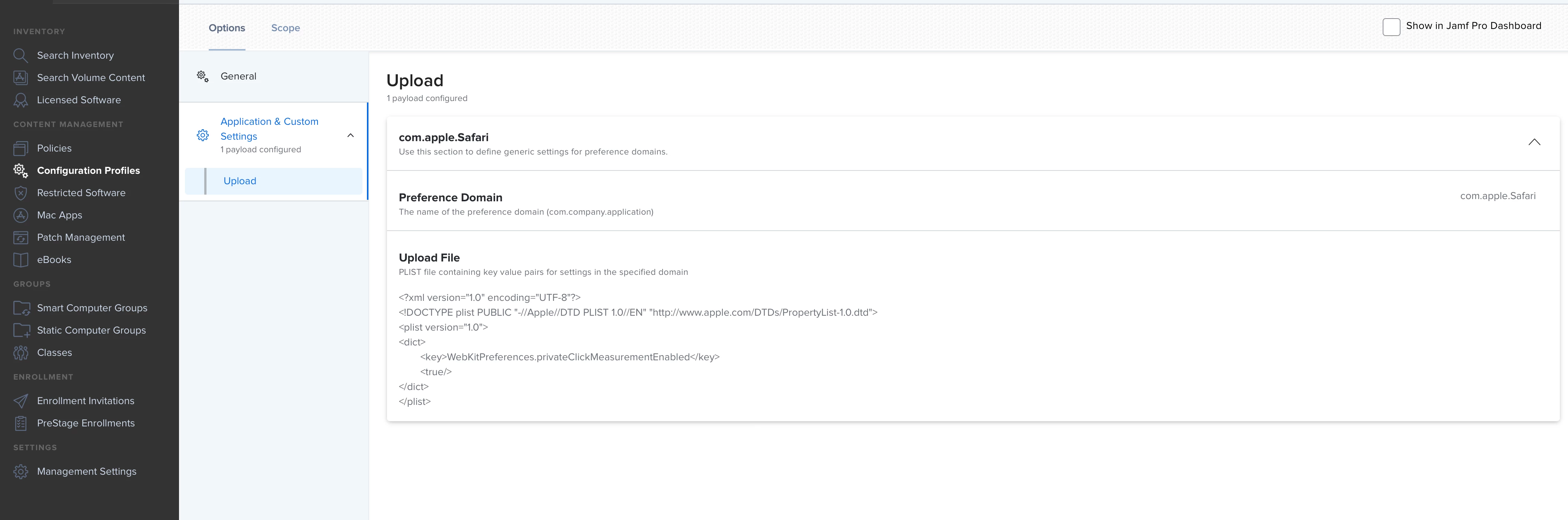

I'm trying to set the preference for Safari via a configuration profile. Is this possible with a config profile? I can't get it to take on Ventura.

Hey there, the CIS page actually shows that this can indeed be set with a config profile like yours. Note that the checkbox will not be disabled but if you uncheck it and relaunch Safari it'll be checked again.
mvu
  • Jan 25, 2023 3:31 PM UTC
Oh. I was off because I thought the box would be grayed out. Thanks, I tried it again and your right: It is checked again. Thanks, @jmahlman
I did a script below, but the config profile is better.
currentUser=$(ls -l /dev/console | awk '{print $3}')
sudo -u $currentUser /usr/bin/defaults write /Users/$currentUser/Library/Containers/com.apple.Safari/Data/Library/Preferences/com.apple.Safari WebKitPreferences.privateClickMeasurementEnabled -bool true
