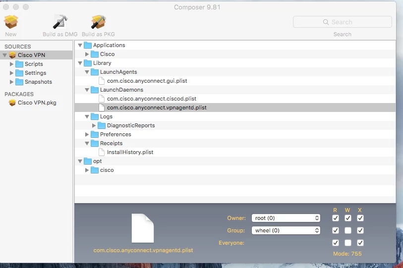

I have created a custom .pkg for Cisco AnyConnect. It seems that after install the service isn't running so you have to reboot for the vpn to work. Can I make this as a post install script with composer and what service would that be?
This package is an example of one where I would consider using the vendor-provided package as its scripts make changes to various things in the network stack.
If we want to customize, what I might do is create a "helper package" that is essentially a snapshot from the point of finishing the install the vendor package to the point it is ready for the end user to login with. That way you can populate preference files and such. You could also consider installing with Cisco's AnyConnect profiles as well, but may take some more advanced packaging. A snapshot is not a great choice here simply because AnyConnect does have an impact on network settings.
The vender told me to do this and they offer no other solution that what I have done. I just need the VPN server to start after the install.
This is currently what I'm using for AnyConnect.

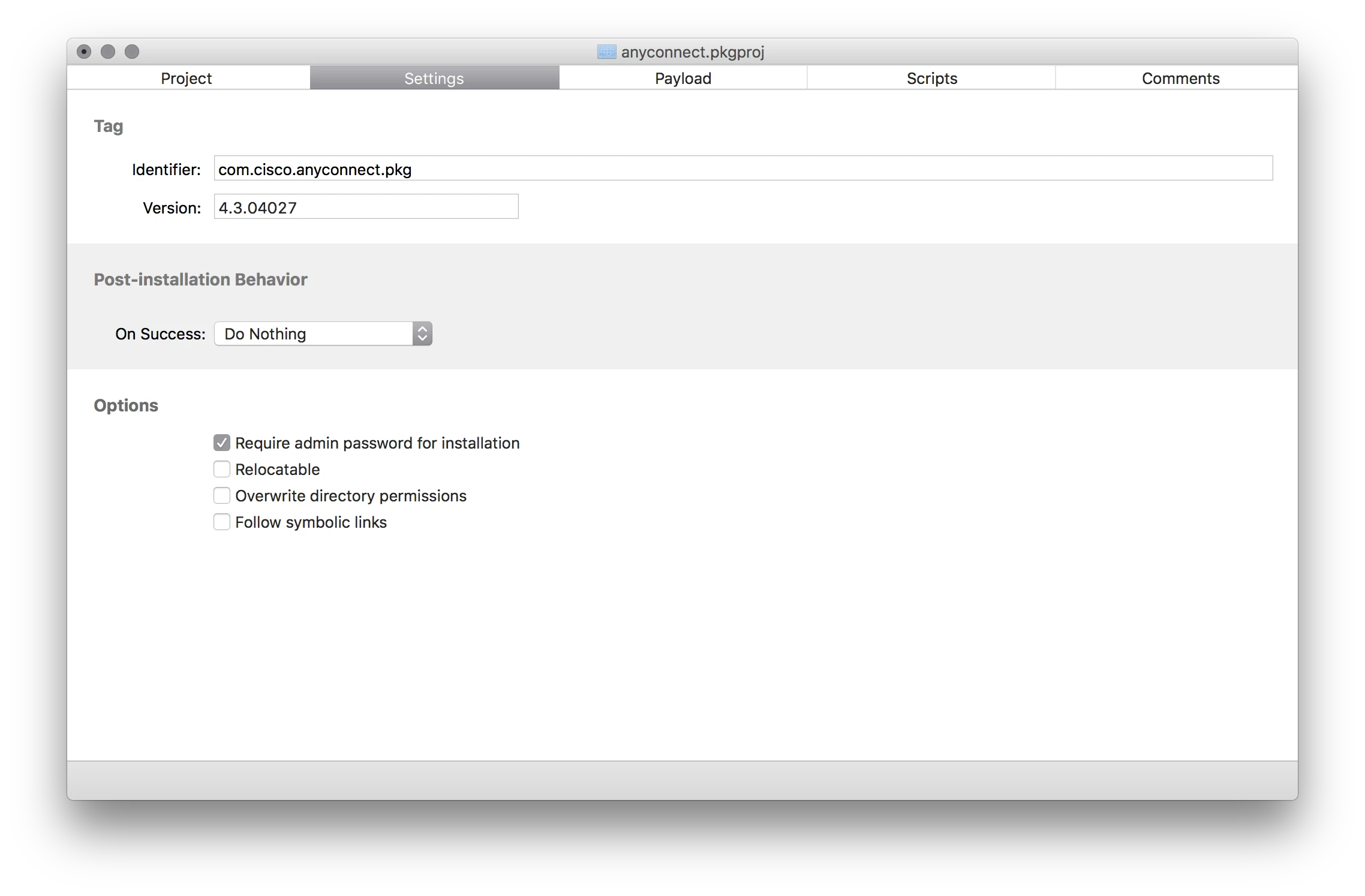

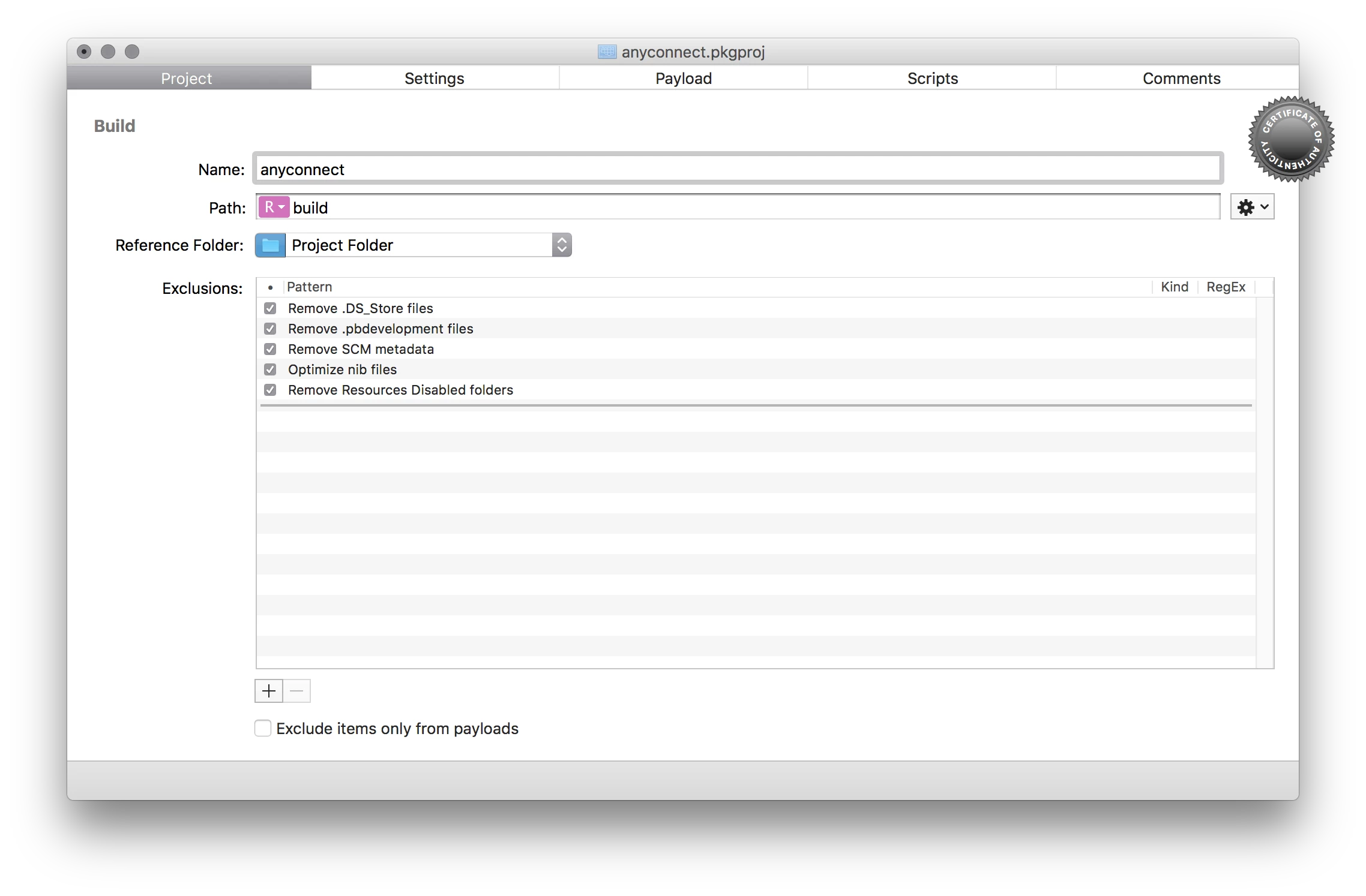

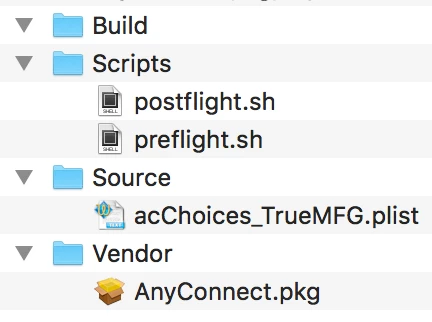

Create Wrapper package:
Create folder for AnyConnect Packages project. Here is how I structure my folders:
Open the Packages app to create a new Raw package and name it anything you like:
Choose an identifier (ours is com.cisco.x.x because we are Cisco. I would use something unique to you) and supply a version number for your package. I make the version number match the version of AnyConnect:

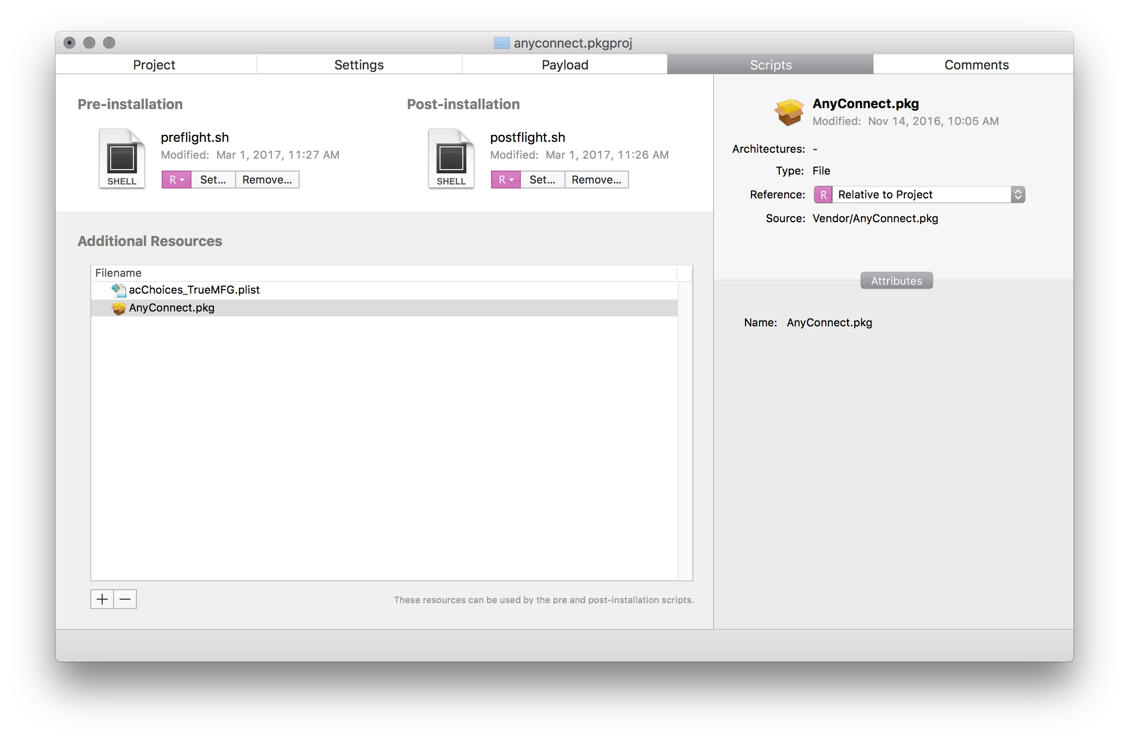

There is no payload to specify so you can skip this screen.
On the Scripts tab add your Pre and Post scripts and add the Choices xml and vendor package as addition resources:
(The file can be named whatever you would like. This was an example for @kericson )
Save the project and then choose to build it. You should now have a package, though unsigned, that will install only the modules you want. If you need to install profiles or other files you can create further packages or simply add to the payload. Packages can apply a cert to your package if you have one or you can sign it after you build it.

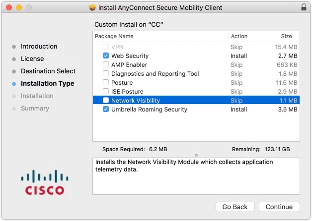

@winterboer Its an XML file you feed to the command line installer application to tell it what your choices are for what you are choosing to install. Its the XML equivalent of checking what you want to install in the GUI based install. You can learn more by looking at the man page for installer. But basically its how you specify what's in this screenshot when you are doing an install from the command line.
@chriscollins I built a custom installer using the directions above and I ended up with everything installed, I just want the VPN client. When I ran the GUI based installer it only offers VPN, everything else is greyed out.

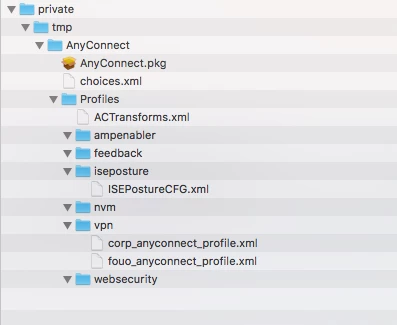

@iJake Quick question: what is the best way to install profiles for the various modules with your workflow? I'd like to just add it to the package that has the vendor installer and Choices Plist.
@iJake Never mind, i see the answer above.

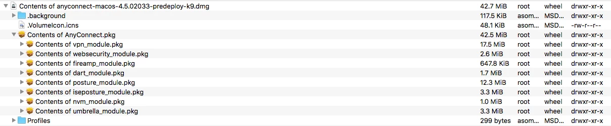

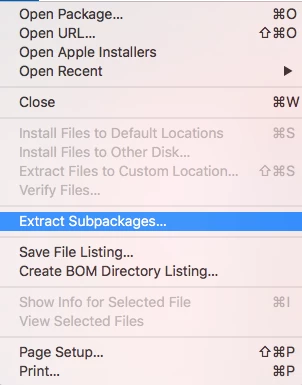

I know this thread is a bit old but I was able to successfully deploy the Cisco AnyConnect VPN module and the ISE Posture Module (the only two we use) separately by extracting them with Pacifist. Yes I have to upload two separate .pkg's to the JSS but the result was smooth and everything works great.
- Open .DMG with Pacifist and navigate to the AnyConnect.pkg
- The dropdown will show you the packages for all of the modules within the main AnyConnect.pkg
- Choose the ones you want to deploy later and use the "Extract Subpackages" option.
- Upload to the JSS and create your policy for deployment. Thats it.
Hope this helps anyone not keen on editing XML and plist files.

With this installer it does not show how you are supposed to add your own VPN Profiles. Also how are people dealing with the KEXT issue with 10.13 and the new version of anyconnect?
