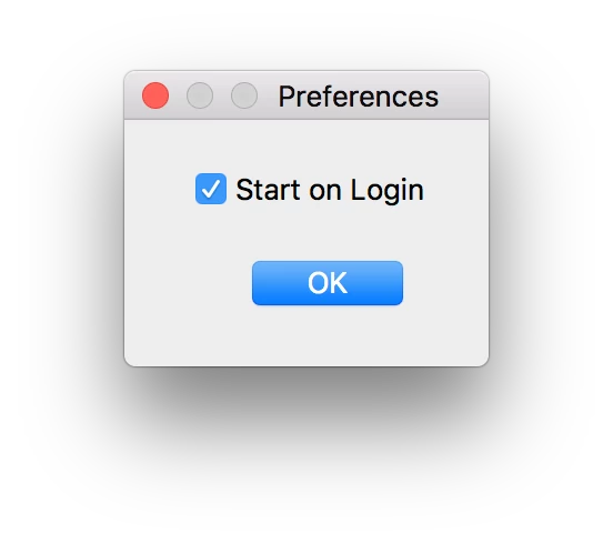

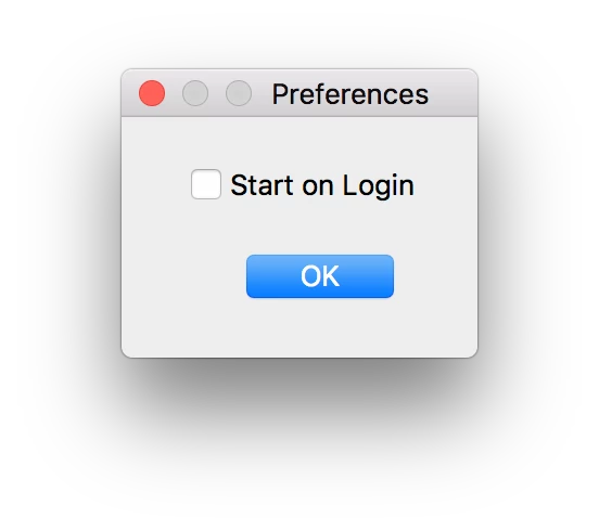

The latest version of Proximity app has a check-box in Proximity | Preferences for " [] Start at Login". Just un-check to turn OFF the launch at login.
